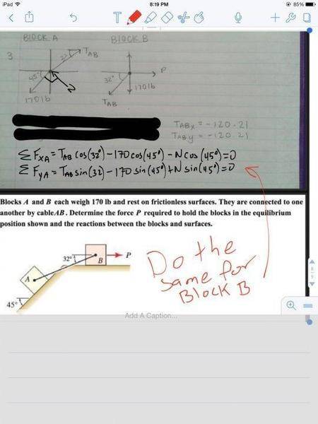

Blocks A and B each weight 170 lb and rest on frictionless surfaces. They are connected to one another by cable AB. Determine the force P required to hold the blocks in the equilibrium position shown and the reactions between the blocks and surfaces.
Hint given: This problems requires two separate FBDs of blocks A and B. Isolating each block requires a closed surface that passes through the cable and the smooth surface on which it's resting. Examine block A first to determine the cable tension required to keep it in equilibrium. You can then use this information to determine the required force P to keep block B in equilibrium.
Image attached as well as free body diagram:
http://imgur.com/a/FV3NJ
ΣFx=0
ΣFy=0
Basic trig
I drew both force diagrams like the hint suggested and then started to try to find ΣFx and ∑Fy for block A and I don't think I got very far since my numbers do not seem correct (you can see in the picture). I know I need to find tension on block A then from there use that to find P, however I don't know where the angle of block B fits in. In order to keep block B in equilibrium P has to cancel out an Fx components. Just a little stuck on getting there...
I don't understand your FBD for A. You seem to show the weight acting at 45 degrees, and don't show a normal force.
Please correct that and post whatever equations you get.

mrblanco said:
Your equations are wrong. You still seem to have the weight of the block acting at 45 degrees to the vertical. That seems to violate the definition of vertical.

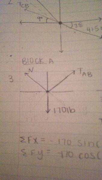

Alright here is my updated FBD.
Would the angle of the normal vector be 45 degrees then? Not sure where that fits in.
Yes, the normal force is called that because it is normal (i.e. at right angles) to the surface. The surface is at 45 degrees to the horizontal so the normal is at 45 degrees to the vertical.
Your diagram is right now, but your equations are truncated in the image. Anyway, posting handwritten working as images is discouraged for several reasons. Please take the trouble to type your equations in. Preferably use LaTeX, or use the subscript and superscript features (X2, X2) in the formatting line above the post area.

The equations I got were:
ΣFx=-Ncos(45°)+TABcos(32°)=0
ΣFy=-170+Nsin(45°)+TABsin(32°)=0
Alison A. said:
Sorry, it was just a little easier to show the FBD in a picture.
Yes. So now you can find TAB and plug that into the equations for the other block. (Please post those equations.)
