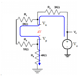

What is the gain error for this opamp driven by a voltage
In summary, the student is trying to determine the feedback factor for an opamp but is having difficulty understanding how to do so.
Boltzman Oscillation
233
26
The op amp has a near ideal level 1 model with G = 5000V/V, ri = inf, ro = 0
How would I obtain the feedback function?
I know I have to find the feedback function which is:
f = - (ΔV/Vin)
I will first drive using the voltage source. My professor said to convert the op amp into a voltage source and short the nodes 1 and 2. He then said to find the feedback function by first finding ΔV = Vp - Vn which he gives (in the solutions) to be -(R1 + R3)/(R1 +R2 +R3 +R4). How did he find this value for ΔV? I can try using the standard way of solving ideal op amps and resulting in two equations:
1: (Vin-Vp)/R3 - Vp/R4 = Ip
2: (Vin-Vn)/R1 + (Vo - Vn)/R2 = In
and then I can solve for Vp and Vn but I do not get the same as he does. I get a value with In, Ip, Vo which he does not have. He only has resistance values in his ΔV. Any help would be appreciated. P.S. Since this is not ideal then I cannot use Vp = Vn and Ip = In = 0 right? thanks

Are you familiar with the DEFINITION of the feedback function (feedback factor)?
Definition: The feedback factor is the input differential voltage (directly across the opamps input terminals) divided by the driving output voltage of the opamp only - that means: With Vin=0 (short between node 1 and 2). Hence, it is a voltage divider expression (Vdiff/Vo) - and Vin must not appear in this function.
It is correct (as your prof said) that for this calculation the opamps output is regarded as an ideal voltage source.
More than that, because the input resistance of the opamp is infinite, you can set Ip=In=0.
But note that for calculating the feedback function you MUST assume, of course, that Vp is not equal to Vn.

Well he actually does have Vin in the function. This is his solution below. I am almost certain he got his Vp - Vn using voltage divider but I can't figure out how. Care to explain?

In the hand-written diagram I an read Vin=0 !
And - yes: The feedback factor is F=7/10-4/10=3/10.
(Two simple voltage divider).

I guess I am not understanding the voltage divider here. Could you explain it?
For the feedback factor:
Vp/Vo=R4/(R1+R2+R3+R4)=4/10
Vn/Vo=(R1+R3+R4)/(R1+R2+R3+R4)=7/10
F=(Vp-Vn)/Vo=-3/10

Look at the current path:
Just a bunch of resistors in series. If you can find the potential across ##R_1 + R_3## then you have ##\Delta V##.
thanks a lot!
