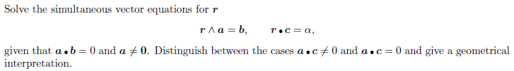

Hi, there is no further information. Does this problem not have a chance to be solved then? I don't know if there is a chance of a typo. I have no opportunity to correspond with the problem setter.

Ah well, it can still be solved.
Let's see what we have.
[1] $\mathbf r \times \mathbf a = \mathbf b$
[2] $\mathbf r \cdot \mathbf c = \alpha$​
We have 1 variable, which is $\mathbf r$.
All other symbols are considered known constants.
From [1] we know that the vectors $\mathbf a$ and $\mathbf b$ are orthogonal.
To get a complete orthogonal basis we need a 3rd vector perpendicular to both a and b.
That would be $(\mathbf a \times \mathbf b)$.
So our known orthogonal basis is: $\{\mathbf a,\mathbf b, (\mathbf a \times \mathbf b) \}$.
From [1] we already know that $\mathbf r$ is perpendicular to $\mathbf b$.
That means that $\mathbf r$ is a linear combination of the other 2 basis vectors $\mathbf a$ and $(\mathbf a \times \mathbf b)$.
Let's introduce the new unknown variables $\lambda$ and $\mu$ and say that:
[3] $\mathbf r = \lambda \mathbf a + \mu (\mathbf a \times \mathbf b)$​
Can you substitute [3] in [1] and deduce something about $\lambda$ and/or $\mu$?
And substitute [3] in [2] and again deduce something about $\lambda$ and/or $\mu$?
If we have both $\lambda$ and $\mu$, we have $\mathbf r$.$\qquad \blacksquare$

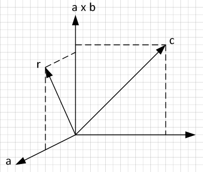

Yep. For myself I have spent a lot of time learning how to make and keep things simple. :D
As for the geometrical interpretation, let's draw a picture.
http://www.mathhelpboards.com/attachment.php?attachmentid=605&stc=1
The vector r is a linear combination of a and (axb).
And if (a.c)=0, that means that c is perpendicular to a.
This means that c is a linear combination of b and (axb).
As we have seen, in that case it is impossible to find $\lambda$.
That is because no matter how much the vector a contributes to r, we get the same dot product $(r \cdot c)=\alpha$.
When c is not a linear combination of b and (axb), the contribution of a to r can be determined uniquely.
