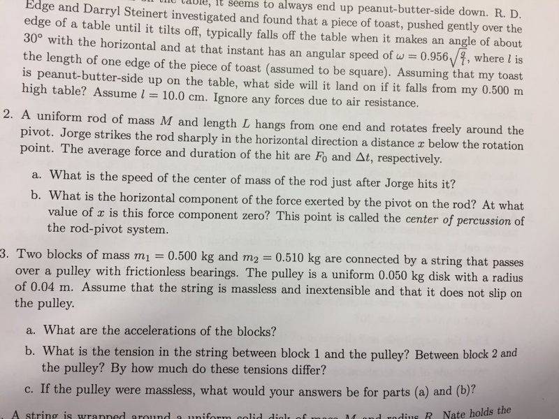

A rod swings freely about a pivot. Is has mass M and length L. The average force and duration of hit are Fo and t respectively. A) What is the speed of the com of the rod just after It is hit? B) what is the horizontal component of the force exerted by the pivot on the rod? At what value of x is the center of percussion?
The pivot is at one end? It is hanging vertically?
What hit? Is it struck perpendicularly at the free end?
It hangs freely. It's hit with an average force f which causes it to rotate about the pivot. I now know that part B and C are wrong. It is number 2
Thanks for posting the original text, that's much clearer.
Please show your working for part b. The outline you gave is not detailed enough.

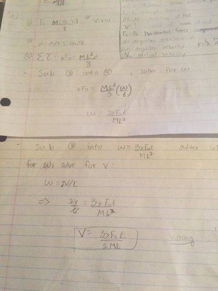

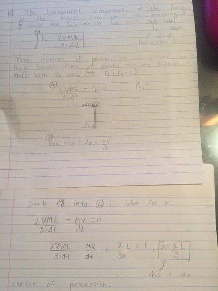

Okay. Uh, part A is wrong...the moment of inertia is actually ML^2/3. To go about part A this is what I did... please tell me if this is correct because I have absolutely no confidence in my ability to do physics at this point. I don't know what to do for B - all I know is that the force at the bottom is equal to the force at the top which is determined by the torque of the pivot point at the top and the force that is solved for by rearranging part A for the bottom. I know that x needs to be 2L/3, I just need to show this. I can't come up with a correct equation to equate the torque and force respectively. And if part A is wrong I can say goodbye to this entire problem, anyway. So that is my first priority right now.

There is no part C, lol.
Vitani11 said:
part A is wrong
What makes you say that? I also get ##\frac {3xF_0\Delta t}{2ML}##. The only thing I see wrong with your answer in the attachment is that you have renamed ##\Delta t## to just t.
If that were true there would be no acceleration of the rod's mass centre.
Likes Vitani11
Wow. That is honestly incredibly reassuring. Okay then... now onto B. Valid??
Your image is a bit faint for my old eyes, but the final answer is right.
Likes Vitani11
Awesome. Thank you so much.
