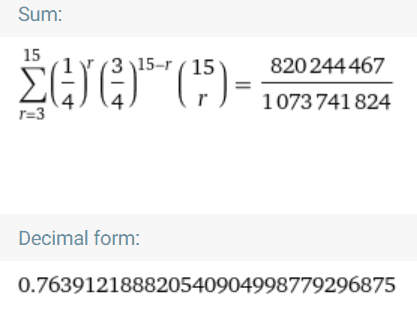

To approach this, I first assumed the case when the students attempts all the remaining questions.
Probability that they gain 4 marks for a guess = ##\frac 1 4##
Probability that they lose 1 for a guess = ##\frac 3 4##
Now let us say the number of correct guesses = ##r##

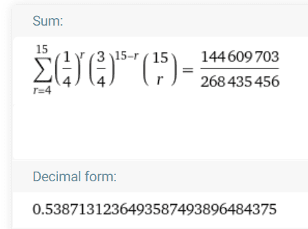

Now we should have at least 3 correct guesses,
because in this case they will score
45⋅4+3⋅4-12⋅1=180+0 marks
So our required probability = ## \sum_{r=3}^{15}\binom {15} r \frac 1 4^r \frac {3} {4}^{15-r}##
this gives us
So, there is approx 76% chance that they can benefit from attempting all the remaining questions.

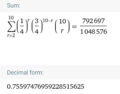

Now, just to get a better idea of the situation, let's consider another scenario where the student knew the correct answers to 50 questions.
Here it might seem that if the student knew more,
then the risk of attempting rest of the questions should be lower.
For this is the case, our limiting value is 2 correct guesses as 2⋅4-8⋅1=0,
Surprisingly, here we have only 75% chance to benefit!
So, its actually less than the previous case. So, this definitely doesn't work as I thought it should.

I don't understand the question.
First, if the student has 45 questions correct, then he/she already has 180 marks, so they are certain to score the required 180 marks with no guesses. The optimum number of guesses, therefore, should be zero. But, I suspect this is not what the question setter intended.
What is the question asking? To optimise the probability of getting strictly more than 180 marks?
What you have calculated is the probability that they answer 3 or more questions correctly if they guess the remaining 15 questions, hence either benefit or break even by guessing all 15. How do you know you can't do better than this by guessing fewer questions? And, you can do better by not guessing at all.

If we imagine, however, that to get an A you need 181+ (and you need/want to get an A), and you have only 45 x 4 = 180 points, then you are forced to guess. Then it's an interesting and unsual question. Do you guess all 15 or is there a better strategy?
