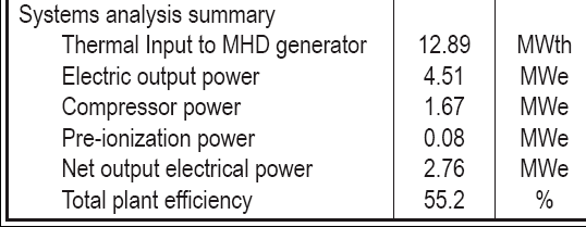

Yet another paper.
This one is interesting, it has a rather low radiator temperature, and this is justified in that apparently the specific power (W/kg) of any heat engine, or in this case MHD system increases rather rapidly with a smaller temperature differential. Radiator mass quickly becomes the least of the problems, as generators, turbines and so on goes bulkier.
How can a plant with 12,89MWt and 2,76MWe be said to have a "total plant efficiency" of 55,2%?
If 10,13MW doesn't end up as electric power, then that must be radiated off, which would be 22056,7m^2 of radiator, yet apparently that doesn't blow the concept out of the water.
I'm missing something here... Also, in the diagrams it looks like 600K would have the lowest alpha, which if I understand it correctly in this context means weight-to-power ratio.

The efficiency doesn't look right given the net output and thermal input, but I'll have to read the paper to understand what they are talking about. Also, they are short on details of the NFR, and 1800 K is rather hot. I'd be curious about the reactor and fuel design. Fission products are rather mobile a those temperatures. I wonder if they plan on venting the Xe and Kr from the fuel.
