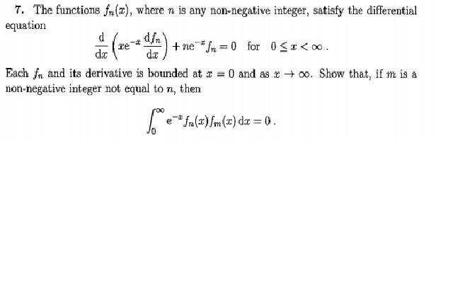

See attached.
I integrated the equation with respect to x to obtain
∫[itex]\frac{d}{dx}[/itex](x[itex]e^{-x}[/itex][itex]\frac{df}{dx}[/itex])dx+∫n[itex]e^{-x}[/itex]fdx= constant
The first term on the left hand side goes to zero as x, df/dx are bounded at 0, infinity. This leaves the expression ∫n[itex]e^{-x}[/itex]fdx= constant which is not the one given.
hi eas123! :smile:
what happened to m ? :confused:
Hi. :-)
What do you mean? I don't know how to derive the expression.
your expected answer, ##\int_0^{\infty} e^{-x}f_n(x)f_m(x) dx = 0##, has an "m" in it
i don't see an "m" in your actual work
So where have I gone wrong?
i'm completely confused :redface:
you seem to be solving a different problem :confused:
start with ##e^{-x}f_n(x)f_m(x) dx = 0##, and integrate it :smile:
eas123 said:
See attached.
The following is an image of the attachment. Please notice that the result you are to prove contains both n and m . That's what tiny-tim is telling you.
