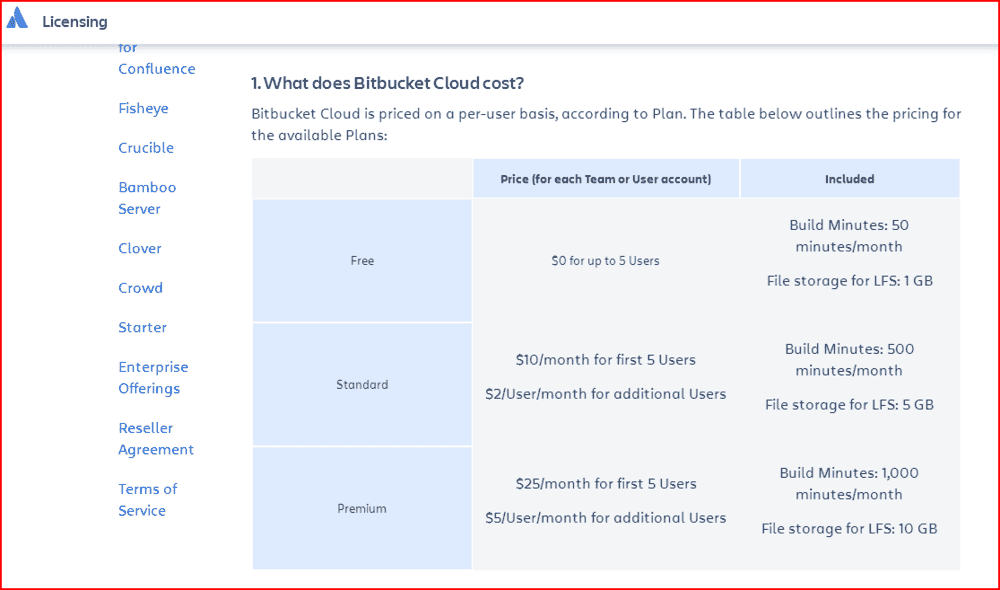

And if they happen to have used some source control system already (I think Bitbucket licenses for individuals are free...), that goes a very long way in showing us that they are serious about wanting to develop quality code as a member of a programming group...
https://www.atlassian.com/licensing/bitbucket-server#cloudlicensing-1
242468
