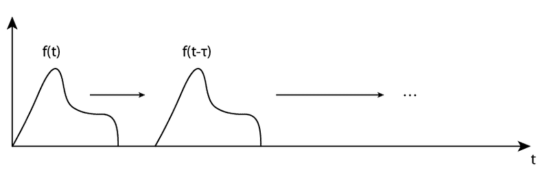

It's pretty simple to explain, though. Observe any function with a finite integral over the R line
[itex]\int f(t)dt=A=const.[/itex]
And now look at the function
[itex]G(\tau) = \int f(t - \tau)dt.[/itex]
Now, for any finite [itex]\tau[/itex], [itex]G(\tau)=A[/itex], obviously.
However, I asked myself what is the answer for [itex]\lim_{\tau \to +\infty}G(\tau)[/itex]?
I'm not sure if I have or don't have the right to exchange the limit and the integral
[itex]\lim_{\tau \to +\infty}\int f(t - \tau)dt =\int \lim_{\tau \to +\infty}f(t - \tau)dt[/itex]
mainly because I have no idea how to interpret this
[itex]\lim_{\tau \to +\infty}f(t - \tau)[/itex]
So, what say you? I'm clueless.
Thanks!

Er, what's wrong with this? f denotes an ordinary function, right? (or are you doing something weird with, e.g., distributions?) So for each value of t you're taking the limit of a single-valued function of one variable. (and so the result is a function of t)
(And no, in general yo do not have the right to do the swap. It's easy to come up with examples that disprove it)

Hm, you got to point there. I guess I just have a problem visualising it:
It never stops moving to the right, right? So I wasn't able to visualise this function of t, which is to be integrated. Still can't.
So, if I understood correctly, [itex]\lim_{\tau \to +\infty}G(\tau)=A[/itex]?

The only thing that is still uncomfortable for me is that I can't seem have an analytic form of the function which I integrate, e.g. if I tell you the analytic form of the function [itex]f(t)[/itex] is [itex]f(t)=e^{-t^2}[/itex], could you tell me the analytic form of the function [itex]\lim_{\tau \to +\infty}f(t-\tau)[/itex], as a function of [itex]t[/itex]?
[tex]\lim_{\tau \to +\infty}f(t-\tau) = 0[/tex]
(In fact, the limit is zero no matter what f is, so long as [itex]\int_{-\infty}^{+\infty} f[/itex] is finite and this limit exists)
