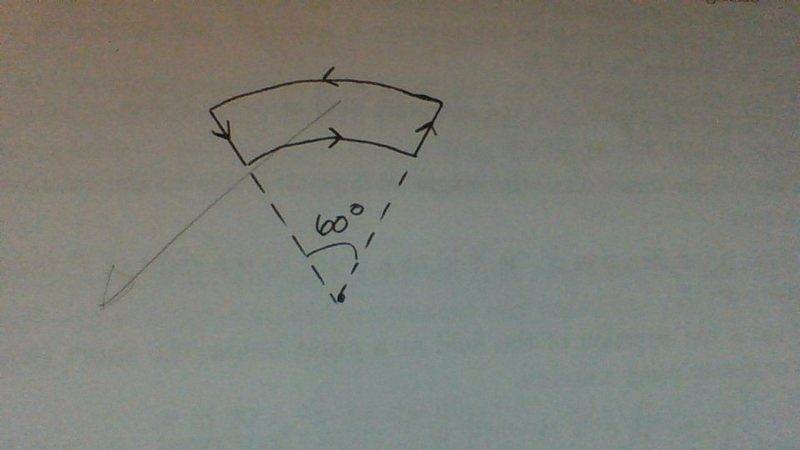

A closed loop carries a current of 8.0 A in the counterclockwise direction. The radius of the outer arc is 0.6m and that of the inner arc is 0.40m. What is the magnetic field at P?
F = ILxB
F = qV x B
R = outer radius
r = inner radius
[/B]
ILxB = mV2/R
I don't even know how to APPROACH this problem. Please help me. These equations above have too many unknowns to give me an answer and so I need more. I can find L but I can not find m and V in terms on knowns, and even still I think this is a horrible way of solving the problem. I would like to do a sum of forces but ∑F = ILxB + qvxB = ma doesn't exactly help because if I replace a with mv2/R I still have as many unknowns as before but this time I need q and v.
There is a concept I'm not getting. The majority of the problems on this homework set are like this - so if I can understand how to approach one of these I can approach many. For example a lot of these require me to relate the B field and time, acceleration, etc. but only in terms of B and I.
This problem does not involve force. So, your "relevant" equations are not applicable.
You need to find the magnetic field at point P. The field is due to the current in the wire. You should have covered some methods for finding the field produced by a current.
