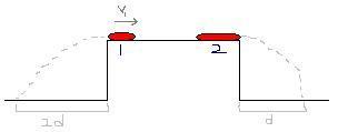

Here is the problem as it reads out of the book.
In the figure, puck 1 of mass .2 kg is sent sliding across the table [frictionless] to undergo a one-dimentional elastic collision with stationary puck 2. Puck 2 then slides off the edge and lands a distance d from the base of the table. Puck 1 rebounds from the collision and slides off the opposite edge of the table, landing a distance of 2d. What is the mass of puck 2?
The figure mentioned in the question is fairly well described in the problem, it is a leven, frictionless table with 2 pucks on it.
Here is what I make of the question.
since puck 2 slides a distance "d" from the table while falling and puck 1 slides "2d", I conclude that puck 1 has twice the horizontal velocity, although negative) as puck 2 when it left the table (and also just after the collision since the table is frictionless). Since puck 1 is sliding one direction at the start of the problem, stops and then reverses direction and has a larger speed, its mass must be smaller than that of puck 2. Since this is an elastic collision, conservation of kinetic energy and conservation of momentum apply.
I will make a guess that puck two has twice the mass (.4 kg) of puck 1, thus casing it to have half the kinetic energy aftter the collision. Although I don't know how to prove this, mathmatically, how do I show it?
Could you please attach a drawing...?
Daniel.
Here is the diagram given.
[it currently just needs approval]
Right!
Exactly right.
You were doing great up to this point. Why did you decide to guess? Write the equations describing conservation of energy and momentum and solve for the mass!

Here are your three equations:
[tex]\rmtex{(#1) }v_{1f} = -2v_{2f}[/tex]
[tex]\rmtex{(#2) }m_1 v_{1i} = m_1 v_{1f} + m_2 v_{2f}[/tex]
[tex]\rmtex{(#3) }m_1 v_{1i}^2 = m_1 v_{1f}^2 + m_2 v_{2f}^2[/tex]
Here's what to do: First, use equation 1 to eliminate [itex]v_{1f}[/itex] in the other equations. Rewrite equations 2 & 3 as simply as possible. Then square equation 2 (both sides). Then you can eliminate [itex]v_{1i}^2[/itex] by combining equation 2 (squared) with equation 3. Take that final equation and solve for [itex]m_2[/itex] in terms of [itex]m_1[/itex]. You'll find that things will drop out nicely.
Once you do this I will show you another "trick" to use for elastic collisions.

Right. I'll rewrite it:
[tex]m_1 v_1^2 = m_1 (-2v_{2f})^2 + m_2 v_{2f}^2[/tex]
[tex]m_1 v_1^2 = v_{2f}^2 (4m_1 + m_2)[/tex]
Now multiply by m1:
[tex]m_1^2 v_1^2 = v_{2f}^2 (4m_1 + m_2)m_1[/tex]
no it would seem that I have 2 equations for the same thing,
m1^2*v1^2 = ...
Right... and if two things are equal to the same thing...?
Please write a new equation: set the right side of both equations equal to each other and see if you can now solve for m2. (The [itex]v_{2f}^2[/itex] factors will cancel.)
