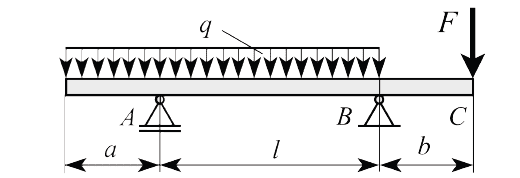

What is the maximum bending moment for this beam?
In summary: When determining the support reactions, the UDL can be represented by a single concentrated load of 11,200 N acting at the center of gravity of UDL, that is, at (a + l)/2 from the left end of the beam.

Problem: For the beam according to the image, solve graphical and analytical:
1.) Reactions in the supports,
2.) Bending moment diagram,
3.) Maximum bending moment
Given variables:
F = 14 kN
q = 40 N/cm
a = 100 cm
b = 55 cm
l = 180 cm
This is a Beam with both overhanging supports, with a UDL and a point load on the right overhang. And I cannot find information for solving this.
Sorry for my terminology, I am doing physics in another language.
I am having a lot of trouble with the solving of this problem. What really confuses me is the UDL (I hope this is the correct terminology) that isn't over the entire beam, but hangs off on the left side.
I can't find any problems in my book that solve this kind of problem, and the professor didn't go into detail.
My attempt at this was trying to figure out the force F[itex]_{q}[/itex], with: F[itex]_{q}[/itex] = q*l => 40 * 280 = 11200 N/cm, 112 N/m, 0,112 kN/m
And assuming that the above is correct, which I do not know, I can go ahead and find F[itex]_{A}[/itex] and F[itex]_{B}[/itex]

The numbers are right, but not the units. If you multiply N/cm by cm what do you get?
Just N?
Antex said:
Just N?
Yes.
haruspex said:
Yes.
Could you explain me the difference if there was no overhang at A, and the UDL ended at A? Is there a different process in calculation in that case?
And also: 11200 N is then 112 kN? or would it be N/m and then 1.12 kN?
1. The difference is in the position where Fq "grabs". Otherwise same calculation.
2. No: 11200 N = 11200 N / (1000 N/kN)
or if you are word-oriented: eleven thousand 200 = eleven thousand plus (200 * thousand/thousand) = (eleven plus 200/thousand ) * thousand​
