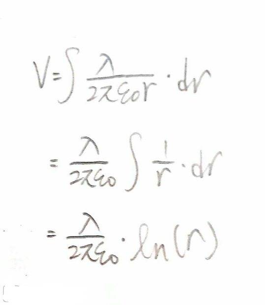

I think I has proved the formula for the electric field as my attachment in post #3(as below):
V=∫ (λ/2πε0r)⋅dr
= (λ/2πε0r)∫ (1/r)⋅dr
= (λ/2πε0r) ln r
Could you give me some more hints if it is not you want me to do which I attached in post #3 (as above)?

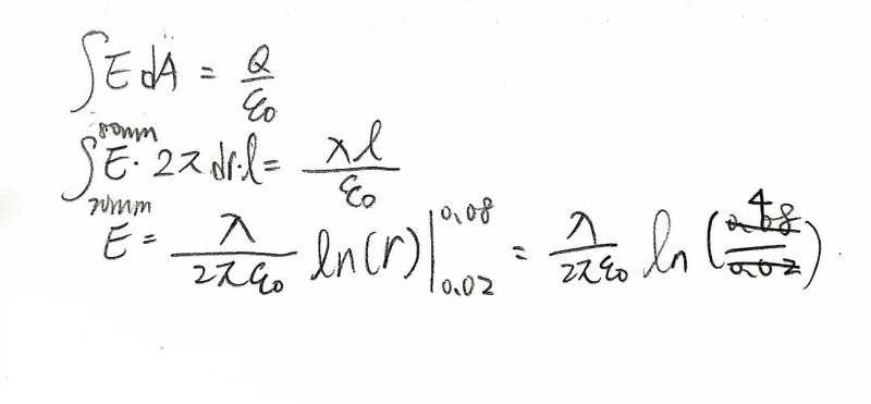

That's the proof of the formula for the potential. The formula for the electric field ##E=\frac{\lambda}{2\pi\epsilon_0}\frac{1}{r}## you haven't prove it yet. To prove it you need to use Gauss's law and take as surface a cylinder with radius r in between the radius of 20mm and 80mm.
Your first line is correct, but then i can't understand what you are doing in 2nd and 3rd lines. In 2nd line you have what it seems to me a line integral which simply is incompatible with the surface integral at line 1.

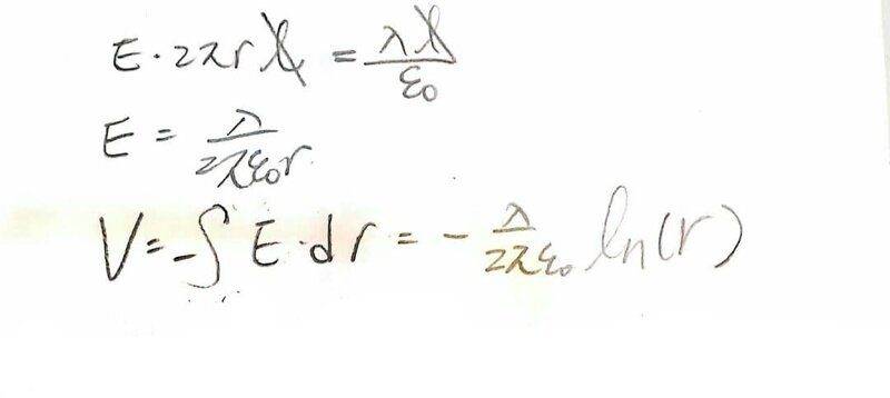

How can you proceed from line 1 to calculate that integral. Remember that our surface is a cylinder with radius r 20mm<r<80mm. Answer this question: How is the electric field magnitude and direction over this surface?
Is it correct?
Yes that is correct well done!
Thanks for confirming.
However, I am still unsure how to answer "What is the maximum electric field magnitude between the cylinders?"
As I calculated previously,
700 = λ/(2πε) *1.4
E = λ/(2πεr) = 700/(1.4*r) = 500/(2*10^-3)
I use 20*10^-3 meters to plug in 'r' and get the correct answer, but I"m not sure why.
Well , r varies between 20 and 80mm. What can you say about the electric field as a function of r? when we increase r what happens to electric field? it increases or decreases? So the maximum value of E field is for low or high value of r?
Thanks for the hint. I got it!
