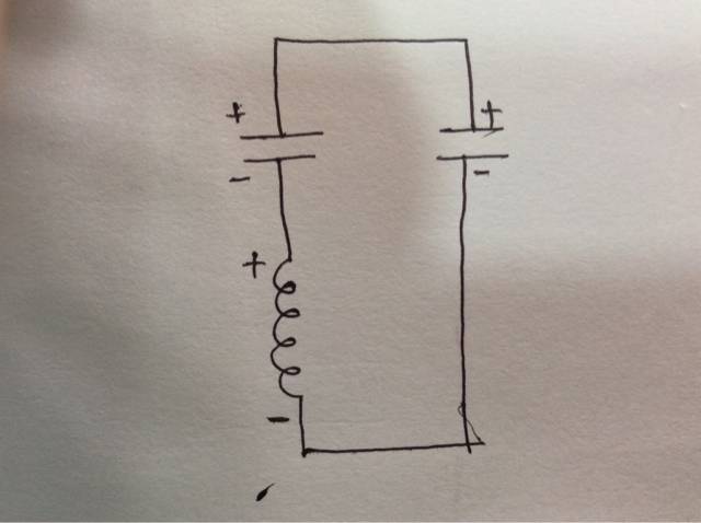

Yeah, I know i am doing something wrong there. Is this sign assigning(new attempt) correct?

randomgamernerd said:
Yeah, I know i am doing something wrong there. Is this sign assigning(new attempt) correct? View attachment 225318.
Yes, but you need to assign quantities as in your earlier post and add the potentials up correctly.

ok, i am trying this sum again now..
okay, so now I have:
LdI/dt = (2x-CE)/C
Differentiating with respect to time,
Ld²I/dt²=2I/C
This gives me a new equation, and now w’=√(2/LC)
Initially current was CE/√LC.
Since there is already some current initially, I think the equation should be I=I₂sin(w’t +φ)
I₂=Qw’.
what is this new Q? how do I find this?

I=CE/√LC , q=CE. Now here comes another confusion. Regarding the C I am denominator of equation A, should i take value of capacitance as just C or should it be the equivalent capacitance? if its the later case, I assume they are in parallel. Right? because same side plates have same signs.
Don't be confused by the leftmost part of the original circuit. With S1 open you can remove that. You just have the inductor and two capacitors connected ... how?
But the way I have assigned the signs in post #3, won't I consider that they are in parallel?
(Although I am getting the correct amswer if I assume them to be I am series, but just confirming all the concepts)
Do these signs have no role in deciding if two capacitors are in series or parallel? (because the leftmost capacitor acts like a cell after t₀)
Having equal potential difference is the only condition?
No.
If you ignore the inductor, just treating that as a conductor, it is not possible to say whether the capacitors are in series or in parallel. It depends what points you take as their connection to the outside world.
If you take those points as being on the top horizontal wire and the bottom horizontal wire then they are in parallel; if as the ends of the inductor then they are in series.
I agree it is unusual to see that charge pattern on capacitors in series, but it is just a consequence of how they have been charged.

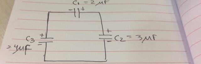

okay, and what about a case like this?
Here is this not equivalent to a circuit where C₁ and C₃ are in series and C₂ is conncected in parallel to them?
okay, and what about a case like this?View attachment 225366
Yes, but as I wrote, it depends where you take the connections to the outside to be. It could turn out to be three capacitors in series, or any two in series with the third in parallel to that pair.
In image posted in #15, this is only what has been given in the question and we were asked to calculate final charge on each capacitor
So do I consider them in series or not while calculating common potential?
I am confused[emoji28]
There will be three potentials. You can assign unknowns to those, and to the charges, and write out an equation for each capacitor.
Or you could treat two as in series and just write equations for those as a single capacitor and for the other by itself.
[emoji848]Well, if i consider final charges on them be Q₁, Q₂, Q₃, then I am getting two equations, 1 from conservation of charge, and other from kirchhoffs loop rule. where do I get the third equation from?

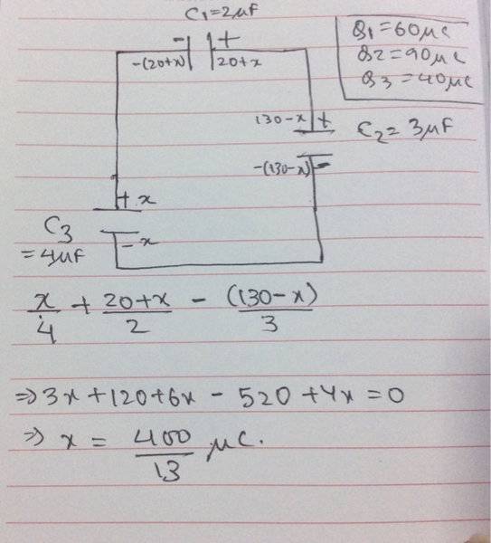

I’m so sorry for bothering again because of this one single sum, but could not reach the answer. I hope this os what you meant[emoji1427]
I’m so sorry for bothering again because of this one single sum, but could not reach the answer. I hope this os what you meant[emoji1427]View attachment 225600
I'm confused. In the diagram above you have a box showing initial charges as 60, 90, 40. In the circuit itself, taking x as the change in charge, you use 20, 130, 0. In post #17 it was 40, 30, 10.
I can understand that you used x-40 as the change in charge. That would give the x you have at C3 and the 20+x at C1, but not the 130-x at C2. So I think you made a sign error.
Edit: sorry, my sign error. Your working and answer are correct.
40, 30, 10 are the potential difference applied to charge the capacitros, not the charge itself.
Initially total charge is 60+90+40 = 190 ?
so charge on capacitor 2 is 190-(20+x +x-40)?
= 190-( 2x-20)
=210-2x
Am I correct now?
= 190-( 2x-20)
=210-2x
Am I correct now?
Whoops... my mistake :oops:. Your answer in post #27 was correct.

But answer is not matching. They say its 380/13 for capacitor C3.[emoji27]
  • #32
Good point.. but then, for C1, 40*2=?
  • #33
i am so sorry, it will be 80 and I have written 60. I am so sorry...I have got the answer now...I have this exam in a week and i don't know what will happen if i do mistakes like this. Thank you sir for your patience and helping me out. And also for reminding me of this concept. Thank you so much.
  • #34
There's no need to apologise to me. I made mistakes too on this one.
