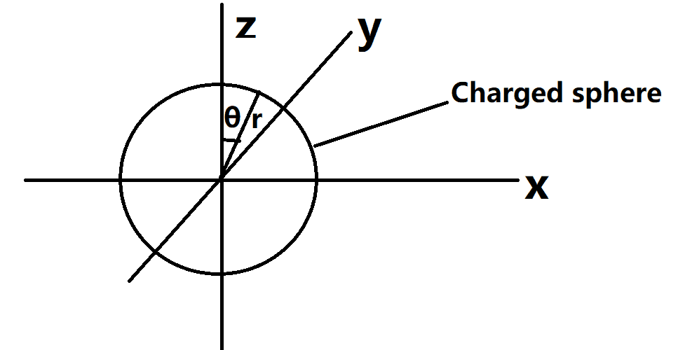

A sphere of radius R, centred at the origin, carries charge density $$\rho(r,\theta) = k\frac{R}{r^{2}}(R-2r)sin\theta,$$
where ##k## is a constant. Find the approximate potential for points on the z axis, far from the sphere.
The multipole expansion: ##V(r)=\frac{1}{4\pi \epsilon_o}\sum_{l=0}^{\infty}\frac{1}{r^{l+1}}\int(r^{'})^{l} P_l (cos\alpha)\rho(r^{'})d\tau^{’}##
The diagram of the problem should look something like this:
,which is just the normal spherical coordinate.To calculate the potential far away, we use the multipole expansion.
##I_o## in the expansion is ok, because ##(r^{'})^{0} = 1##.
However, I am wondering how I should calculate ##I_1##, because ##(r^{'})^{1} = r^{'}##; I have to care what ##r^{'}## actually means. I know ##r## is just the normal spherical coordinate ##r##.
Can anyone kindly explain? Thanks for your answer in advance because I have learned a great deal from the forum!

##r'## is the coordinate of charge particles inside sphere.

Then what is ##r##?
It is called a dummy argument. It still represents the radial coordinate and should disappear after integration (which is a definite integral, don't forget the bounds). It is used so you don't confuse it with the ##r## that is outside the integral.
Likes JD_PM, Tony Hau, Abhishek11235 and 1 other person

To add perhaps a bit more detail:
That's the coordinate at which you are evaluating the potential. You have a potential that is a function of ##r##, and to evaluate it you must integrate over the region of space where there is non-zero charge density. You can't use ##r## for the dummy integration variable, so it's common to use ##r'## for this.
I think ##\vec r## refers to the direction of the radial distance of the potential at a general point from the centre of the coordinate system, whereas ##\vec r^{'}## is the direction from the centre of the coordinate system to the infinitesmal charge; the angle between them is ##\alpha##, which is also the variable in the Legendre polynomial ##P_{l}(cos\alpha)##.
##\alpha## is quite different from ##\theta## because ##\theta## is the angle from the z axis to ##\vec r##.
Tony Hau said:
I think ##\vec{r}## refers to the direction of the radial distance of the potential at a general point from the centre of the coordinate system
I don't know what a "direction of the radial distance" means. ##\vec{r}## is the position vector of the point at which you're evaluating the potential.
