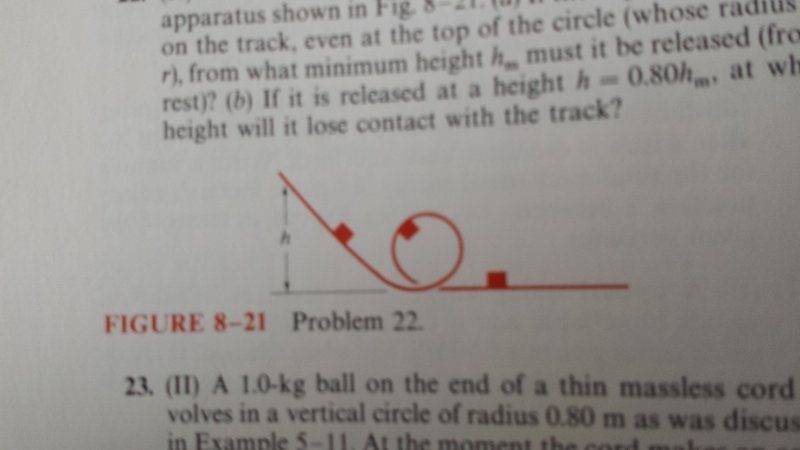

1. Homework Statement
A small mass m slides without friction along the looped apparatus shown in the attached file. (a) If the object is to remain on the track, even at the top of the circle(whose radius is r), from what minimum height hm must it be released(from rest)? (b) If it is released at a height h = 0.80hm, at what height will it lose contact with the track?

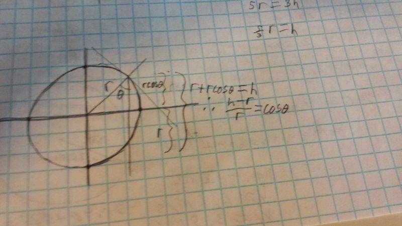

Hello, Ishaan.
Your work for part (a) looks very good!
For part (b) your assumption that v = 0 when the mass leaves the track is not correct. Hint: What force on the mass must go to zero at the instant the mass leaves the track?
Ok.
So I set up an equation.
Fnormal + mgcosθ = mv2/r
where θ is the angle between the normal force and the gravitational force.
I set Fnormal equal to zero because when the object leaves the track, the normal force would be 0.
mgcosθ = mv2/r
I solved for v2.
v2 = rgcosθ
I then set up the conservation of energy equation.
2rmg = mgh + mv2/2.
I substituted rgcosθ for v2 due to my previous derivation. I then canceled mg from both sides.
2r = h + r(cosθ)/2,
Then I set up a diagram that I have attached.
I solved for cosθ using the diagram and substituted it into the above equation.
2r = h + (h-r)/2.
I solved for h and got
h = (5/3)r.
Is this correct?
Thanks.
That all looks correct. Very nice work!
