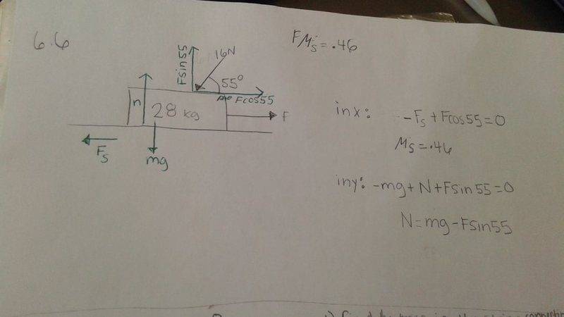

What is the minimum horizontal force F needed to make the box start moving in (Figure 1) ? The coefficients of kinetic and static friction between the box and the floor are 0.25 and 0.46, respectively.
Fs= mu * N
So I know that the normal force is 432 N because of the additional force acting on the 28kg object. The angle is throwing me off a little bit. Since I am only finding the horizontal force would I only take into account cos(55)?

doing the free body diagram I got
in x direction: +F-Fs+16cos(55)=0
Fs=.46
in y direction: +N-mg+16sin(55)=0
am I correct?

I uploaded a picture both methods. Are you able to see it?
Yes, the attached image is fine.
Your force components for the 16 N force are both in the wrong direction. They should sum to give the original force. Your indicated component directions would sum to give a force directed upwards and to the right, exactly the opposite of the original 16 N force vector.
You've also labeled the 16 N force components as Fsin 55 and F cos55, and also labeled the horizontally applied force F. That's confusing because they are not related.

okay so i get why 16 N would be - in the y direction. But why would it be downward and to the left? if that is what you are saying.
Angela_vaal said:
inx
Look at the direction its arrow is pointing. The 16 N force is directed down and to the left on the image . It's pressing down on the block and push it to the left.
okay. I found the Normal force which is equal to 288N. Now would I use the formula Fs=Mu N?
Fs=(.46)(288N)= 132 N

That's the idea. I think you meant to write: ##F_s = μF_N##? Your result for the maximum static friction force is good.
