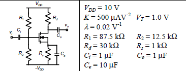

Given the following circuit find the bias point (VDS,IDS).
The first thing I did was find the value of VG, the voltage from the gate of the mosfet to the -VDD source.
VG = VDD * R2/(R1+R2)
To find the current IDS I needed the voltage from the gate to the source, VGS, which is:
VGS = VG - RsID
Since we're operating in the saturation region I can replace ID by:
VGS = VG - Rsk(VGS-VT)^2 (1+λVDS)
where VDS is the voltage between the drain and the source.
I also know that:
VDS = 2VDD - (Rd+Rs)ID
This is as far as I can get. I'm a little confused regarding what I should do next.
If anyone could help I'd appreciate.
Thanks.
Daniel.
Not a good start. Need to fix that first.
Sorry, I meant to write 2VDD instead of only VDD.
Better, but still not right.
VGS = VG - RsID
That equation is also wrong.
You're having trouble with that "-V_DD".
Thanks! I finally got it right.
VG = VDD (R2-R1)/(R2+R1)
VGS = VG - RsID + VDD
ID = k(VGS-VT)2
Replacing VGS in the expression (1) I managed to find the correct solution. I still have one doubt tho.
The value of λ is very small, only 0.02 V-1. When the value is that low can I simply ignore it and solve the problem as if it was zero?
ID = k(VGS-VT)2
OK now.
Since you were given a number for lambda I would retain those values in your answer.
