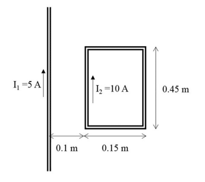

A rectangular current loop carrying ##10A## is near a long wire carrying
##5A## with the geometry indicated in the figure. What is the magnitude and direction of the net force on the current loop?
##\vec B=-\frac{\mu_0I}{2\pi x}## into the page
##\vec{F}=\int I\vec{dl}\times\vec{B}##
The long wire carrying ##5A## current causes a non-uniform magnetic field whose formula is known. I calculated the force exerted by this magnetic field on each of the four sides of the rectangular loop and summed them up. I got the right answer, but a question is nagging me---doesn't the loop carrying ##10 A## current also create a magnetic field?
Hi,
It certainly does. But what about the net force it causes on the current loop ?
Likes Meow12
BvU said:
Hi,
Is it zero? Because an object can never exert a net force on itself?
It is zero. I'm not so certain about the why (I can stand up from a sitting position...).
It sure does and you can use Biot-Savart to find what it is at an arbitrary point in space. Why is that nagging you?
Likes Meow12
I had thought that a side of the rectangular loop may experience forces due to the magnetic fields created by the other three sides of the loop. But I think these internal forces will cancel.
Right. However, all four sides of the loop exert magnetic forces on the long wire and you can easily figure out the net force on the long wire due to the current loop.
Try pulling up on your collar and see if you can stand up from a sitting position. :oldsmile:
Likes BvU and Meow12
Although not by exerting a net force on yourself (it is by exerting a force larger than your weight on the chair).
Likes BvU, Meow12 and SammyS
