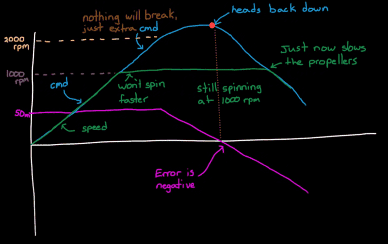

Anyway, I was watching a video on PID and needed to clarify a simple point. It's more of a hairsplitting.
Between and 05:39 and 05:46, it says the following.
"Once the drone gets above the command, the error term becomes negative, and the integral output starts to decrease. However, it's coming down from a value of 2,000 RPM."
The following picture is a capture from the video and I drew the red dot and dashed line. I think that once the error becomes negative, the drone is coming down from a value which is somewhat larger than 2000 RPM. The dot represents the peak value of RPM and looking at the picture it lies at a position which has a value little bit larger than 2000 RPM. Do you agree with me?
This isn't really about PID as much as integrator wind-up, which is really it's own subject, not necessarily part of PID.
I think you have confused the explanation. Blue is the command input which is asking the motor to spin faster than allowed. The motor is never faster than 1000 RPM. Watch the video again and ask if you have questions. I don't want to guess about what confuses you.
I don't think I've confused it but I did use the wrong wording. I've tried to fix it by adding more phrases in blue.

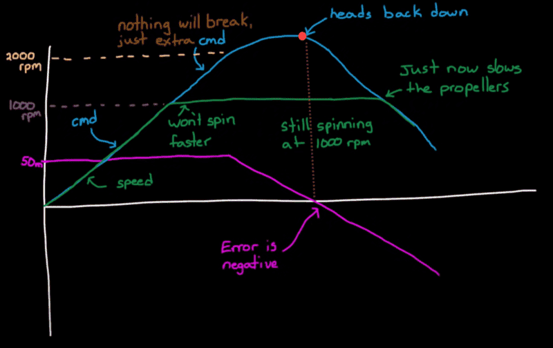

The following picture is a capture from the video and I drew the red dot and dashed line. I think that once the error becomes negative, the command line is coming down from a value which is somewhat larger than 2000 RPM. The dot represents the peak value of RPM demanded by command line, and looking at the picture it lies at a position which has a value little bit over 2000 RPM.
Where in the video, it says, "it's coming down from a value of 2,000 RPM", "it" refers to the value of RPM which had been demanded by the command line of integrator.

OK, sure. Did you have a question about this? I thought he described things pretty clearly. So what are you asking?
No, I didn't have a question about it. Just wanted to make sure what I was saying was correct. Yes, he did a great job explaining the PID.
