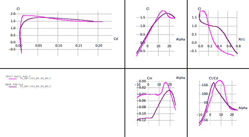

I am a an aerospace engineering student and I am currently engaged in completing an assignment regarding a fictional re-design of the wing on a DeHavilland Twin Otter. I do have some difficulty though, since suddenly I have to independently manage to think about a lot of the details involved in the design of a wing.
The current uncertainty I am facing is that the original airfoil for the Otter had a design lift coefficient of 0.5. I have to see if I can find a better airfoil for the tasks of a maneuverable utility aircraft. Now, when I am trying to find a better airfoil, should I still aim to keep that design lift coefficient as the same number or can I change it? What are the consequences if I choose an airfoil with a different design lift coefficient? I know that if I choose one with a lower design coefficient, the airplane would cruise at a design coefficient that will correspond to a less than desirable lift coefficient. However, I am confused about what happens if my design lift coefficient is higher than the 0.5 of the original airfoil. Would a higher design lift coefficient be beneficial in some way? Could you guys please explain? Any help is greatly appreciated.

Regarding my goals in the re-design of the airfoil - I've decided to try to improve the versatility of the of the aircraft by accomplishing these:
- making the linear part of the drag polar very steep so as to keep drag low at as many values of lift coefficients as possible. I reasoned that this should keep drag low at a wider range of speeds. However, it would mean more drag at the cruise phase of normal transport operations. Climb rate would also be negatively impacted, but since I've been given no guidelines as to what design goals to aim for, I'm inclined to not care.
- increasing the maximum lift coefficient value. I reasoned that this should allow operating at lower speeds without stalling or more payload. Also, it should allow for shorter take-off and landing(not considering the impact of high-lift devices)
- increasing the maximum Cl/Cd ratio that can be obtained. I reasoned that this should allow a longer endurance for aerial surveys or tourist flights. I thought it would also allow easier operation in mountainous or hard to risk areas: the pilot would have more time to make decisions regarding maneuvers since he can fly slower.
- making the moment coefficient curve less negative in most ranges of angles of attack. I reasoned that this should allow a size reduction for the tailplane area, thus lowering the weight of the aircraft. I know this impacts the dynamic stability but I chose to blatantly ignore that since I don't have the time to analyze everything. I wasted too much time already by being too indecisive and making problems very complicated.
In addition, I reasoned that if I increased the lifting capabilities of the airfoil I could perhaps decide to use less complicated high-lift devices and consequently reduce the weight of the wing.
I'd like your opinion on these requirements I set. Are they reasonable or do they make me seem simple in the head?

Regarding the design lift coefficient, I calculated the weights at the beginning and end of the cruise part of the mission. From these, I calculated the necessary lift coefficients - 0.27 and 0.23, respectively. I have the design lift coefficients now. However, as I stated in my mission requirements, I am deciding to make the linear part of the drag polar steeper so as to be able to experience less drag at a wide range of lift coefficients. It seems to me that selecting an airfoil based on these cruise lift coefficients would be counterproductive. Am I correct to say that or would you say that it's still important?
Regarding my original post, I think understand now why the design lift coefficient was what it was in the case of the original airfoil. The cruise design lift coefficients were in the range of the inconspicuous laminar bucket in the drag polar of the original airfoil.

I also included as an attachment a screenshot from XFLR5, which I am using to analyze the airfoils, depicting the original airfoil and the airfoil that I think suits well for the requirements I set. The original one is a NACA 63A-516 and the other airfoil is a NACA 34015 on which I modified the aft part slightly to get a stable moment coefficient.

Sorry, "the linear part" of the lift-drag polar was the wrong thing to say. I meant that before it starts veering off to the right, I would like it to resemble a vertical line so there would be a similar low drag coefficient at most lift coefficients.
