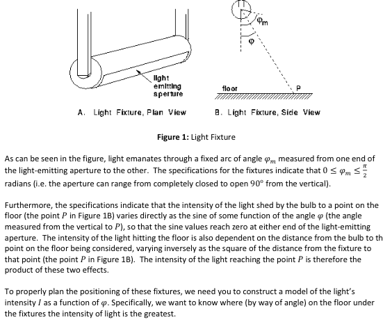

I really need help creating an optimization problem for this, I have this so far..
I(φ, φMax) = Sin(φ * π/φMax)/(Sin(x)2 + 1)
With that said, I don't really understand how to enter values into that equation, "Phi" is really throwing me off, is it a constant or should I treat it as a variable like "theta"??

Hi mathman! Welcome to MHB! :)
Conventionally "phi" and "theta" are both used as variables.
So yes, you should treat $\phi$ as a variable.
In contrast, $\phi_m$ is given to be fixed, and therefore a constant.
How did you find (Sin(x)2 + 1)?
Suppose the fixture is at height $h$ above the floor.
Then the distance to point P as a function of $\phi$ is:
$$d(\phi) = \frac{h}{\cos\phi}$$
The intensity on the floor at angle $\phi$ is:
$$I(\phi) = \text{constant} \cdot \frac{\sin(\pi\phi/\phi_m)}{d(\phi)^2}$$

Wow! thanks, I knew the distance formula was off. As far as this "constant" you referred too in the final problem what is that? Also should phi max be set to any value between 0-90?
It's an unknown constant.
We only know how the intensity varies with angle and with distance.
We do not know what the actual intensity is.
That's why we multiply with an unknown constant.
$\phi_m$ could be set to any value between 0 to 90 degrees, but for the calculation we treat it as a constant.
If you want, you can substitute a number, say 80 degrees.
That may help to remember it's a constant.
Just remember that in the final solution, it should say $\phi_m$ again instead of that number.
The same applies to $h$, which is also a constant.

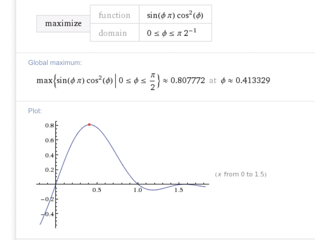

$I(\phi)=sin(\phi\pi)cos(\phi)^2$
so it seems .41 radians or (23.49 degrees) is the optimized angle for the highest intensity possible, given those constants.
Thank you, I am seriously blown away with this website and will be sure to tell all my friends to use this in the future
