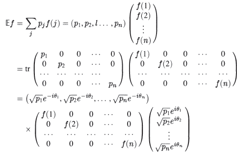

To give a slightly different perspective, when we calculate the average with a density operator ## \rho ##, we multiply ## \text{Tr}(\rho |\psi_i \rangle \langle \psi_i |) ## with the value ##a_i## associated to the outcome ##| \psi_i \rangle ## and add them all up. What do we get? $$ \sum_i a_i \text{Tr}(\rho |\psi_i \rangle \langle \psi_i |) = \text{Tr} \left( \rho \sum_i a_i |\psi_i \rangle \langle \psi_i | \right) $$ So arranging eigenvectors and eigenvalues into a Hermitian operator can be thought of as merely a convenient way to calculate an average.
Likes AdaggerA
Yes, and allowing in place of the rank 1 projectors arbitrary positive definite Hermitian operators leads in this way naturally to POVMs. This shows that the latter are far more natural. The emphasis on the special case of rank 1 projectors (leading to Born's rule) is a historical accident only.

If you take the Heisenberg Uncertainty Principle as Landau-Lifshitz state it, saying 'there is no concept of the path of a particle', motivated by the inability of measuring the path of an electron path through a cloud, then since a path is specified by position & velocity and initial conditions, having measured the positions at each point you measure at implies the velocities f(i) are randomly distributed & that all we can do is find an average velocity along the path. This motivates using the probabilistic notion of 'expected value' to formalize finding the average/expected velocity of, say, n measurements. Then a simple calculation motivates, taken from Parthasarathy's QM book (page 1), different formalisms of quantum mechanics:
The final equality illustrates why you have Hermitian operators acting on vectors, the middle line illustrates the density matrix formalism, the top line illustrates expectation as an inner product.
