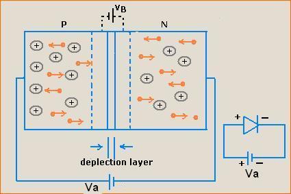

Please read this
http://www.tutorvista.com/content/physics/physics-iv/semiconductor-devices/p-n-junction.php#forward-biasing
Or look at this figure
A p-n junction is said to be forward biased, if the positive terminal of the external battery Va is connected to p-side and the negative terminal to the n-side of the p-n junction. Here the forward bias (external battery Va) opposes the potential barrier VB and so the depletion layer becomes thin.
And because this "depletion region battery" has 0.7V, so to overcome this potential barrier the external battery (Va) voltage must be larger than "depletion region battery" and must be connected in the opposite direction to "depletion region battery".
So only if this is the case ( if the positive terminal of the external battery Va is connected to p-side and the negative terminal to the n-side of the p-n junction) the forward diode current can flow.
  • #33
@Jony130 See all those black ⊕ charges in the N doped material? Shouldn't they be (-)?
  • #34

Note how the picture contradict itself. In big diagram it shows negative terminal(small plate) of VB with P side(right side) but in small diagram adjacent to it showing symbol of diode it shows positive terminal on P side(right side).
How does the polarity reverse if one use symbol instead of two pieces of P and N semiconductor?
