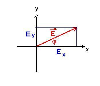

Why don't you draw the vector in the x,y plane? It has x and y coordinates, and magnitude and angle as well. See attachment. How do you get the angle φ from the x, y coordinates? How would you get the magnitude of the vector?
The polar coordinates are the magnitude of the vector and its angle (the polar angle) with respect to a specified direction. The unit vectors are r -hat and φ-hat.
http://en.wikipedia.org/wiki/Polar_coordinate_system
ehild
