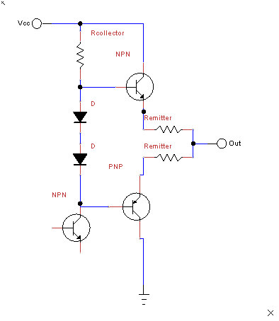

There is a problem with the emitter follower which is seldom discussed. Referring to the figure, pulling current out of the emitter follower is problem-free. The extra current through the output transistor results in a much smaller current through the collector resistance in the previous stage (icollector = iemitter/β). The problem begins when you try to put current into the emitter follower. In order to keep the emitter at the correct potential, the emitter follower must reduce its current into Remitter. Sooner or later you will get to the point where there is no current left in the emitter follower, leaving us with an output impedance of Remitter. This asymmetry creates a lot of distortion when the emitter follower tries to drive a low impedance (for example a loudspeaker).
The usual remedy for the emitter follower problem is to use a symmetrical emitter follower. This version uses complementary symmetry in order to be able to sink as much current as it can source.
