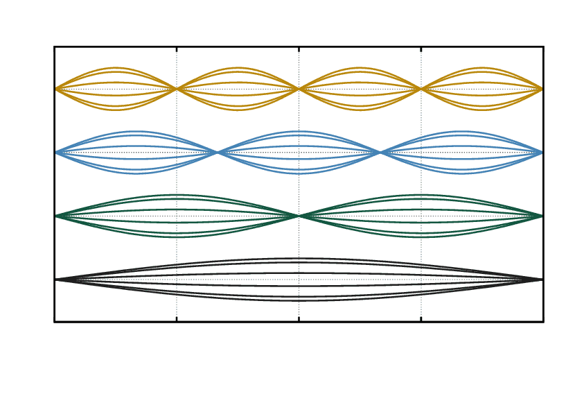

Guitar strings and flutes. People with a musical background have heard of harmonics, use that as a basis for explaining that structures have characteristic (modal) responses. How do they tell a G string from an F string? By modal analysis in their brain. How do they tell if they are blowing too hard into their recorder? By modal analysis in their brain.
Here's a graphical depiction that the public can understand.
You could show how to create a square wave by adding one more harmonic at a time. You could do that with graphics, no math. Then, just say "analysts can do that backwards, starting with the square wave and finding the component harmonics.
