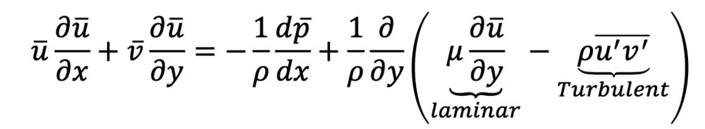

Hi,
I was recently learning about turbulent boundary layers and came across the 'Prandtl mixing length'. I am struggling to understand what the concept is and what its purpose is. I would appreciate any help or guidance of where I can look to gain a better understanding.
The information I currently know is below.
The turbulent 2D boundary layer momentum equation is given by:
Then we can define an eddy viscosity [itex] \epsilon_{M} [/itex] such that:
[tex] \tau_{turbulent} = - \rho \overline{u' v'} = \rho \epsilon_{M} \frac{du}{dy} [/tex]

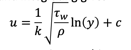

The eddy viscosity varies through the boundary layer. Prandtl’s hypothesis was that the mixing length is proportional to the distance from the wall, [itex] l = ky [/itex] where [itex] k [/itex] is a constant and also the shear stress is uniform and approximately equal to the value at the wall in the region close to the wall, [itex] \tau_t = \tau_w [/itex]. This leads to an expression for the shear stress
[tex] \tau_t = \rho k^2 y^2 \left( \frac{du}{dy} \right)^2 [/tex]
[itex] y [/itex] is the upper bound of [itex] l [/itex] since mixing length cannot be greater than the distance from the wall by our definition. Taking the square root and integrating gives:
That is the text that I have on the topic. After reading this, I am not completely sure what the purpose of this concept is.

The shear stress in the momentum equation is unknown so you need a model for it to solve the equation. Prandtl's model expresses the shear stress in terms of some length scale and the velocity gradients. The mixing length hypothesis gives the simplest model that will allow you to solve the momentum equation.
There is no universal mixing length in turbulent flows, but for flows like free shear flow you can determine a reasonable value for the mixing length for the type of flow you would like to analyze.
These are important concepts, and not every book explains it with the level of detail it deserves. You can check 'Viscous Fluid Flows' by Frank White to see some examples, or Turbulence Modeling for CFD by David Wilcox.
I think the ultimate thing to remember here is that the Prandtl mixing length theory was a simple, early closure model to an extraordinarily complex problem. It works decently under a limited set of conditions but doesn't really have a physical basis, especially since it is based on some approximations that are not well-justified but were the only ones available at the time.
At the end of the day, it's a turbulence model, and as is the case with many things in turbulence modeling, it's really just a knob to turn until your solution matches observations.
Many texts specifically on turbulence should have a good discussion, like Turbulent Flows by Pope or Turbulence by Davidson.
