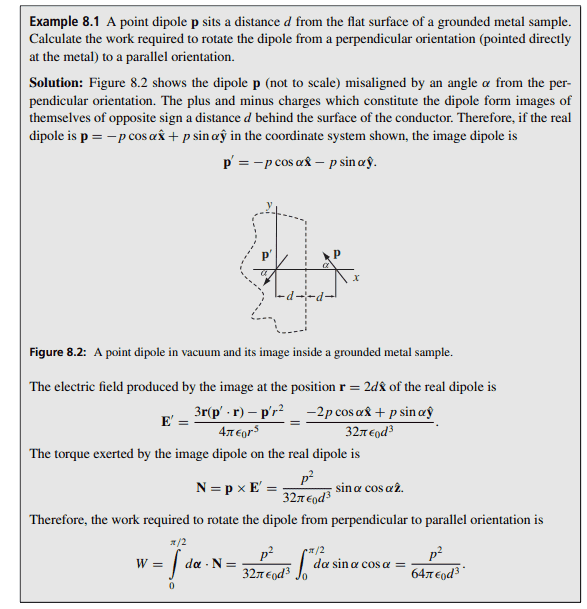

This brief worked example from a textbook section on the method of images is confusing me.
Specifically I am confused about the vector α in the integral on the last line.
When α (or θ) is an angle, I've only ever seen the vector quantity α (or θ) as a polar vector in the plane. But here, that can't be right because the dot product of the unit vectors α ⋅ z = 1, so they are clearly parallel.
What is the correct understanding of the vector α?
It seems like maybe it is supposed to be an axial pseudovector whose magnitude gives a sort of angular position in the plane normal to the vector. But I don't think I have ever seen a vector used this way and I am not sure it makes sense.
It's not a vector but the angle of your real dipole with the negative direction of the ##x##-axis, as written in the solution. The virtual "image dipole" is the reflection of the dipole on the ##yz## plane.
I agree about ##\alpha##, but in the last equation there is a ##d\mathbf{\alpha}## that appears in ##d\mathbf{\alpha}\cdot\mathbf{N}##, which certainly looks like a vector.
I must say I don't recall seeing an angle represented that way, but since angular velocity is a pseudovector presumably ##\mathbf{\omega}\Delta t## is one too.
Note: the alpha in ##d\mathbf{\alpha}## is supposed to be a mathbf alpha, but at least for me it doesn't render noticeably different from a regular alpha. Ditto the omega.
Sorry, I've not read the solution carefully enough. It's of course the axial vector ##\alpha \hat{z}##, describing the rotation of the dipole around the ##z##-axis.
