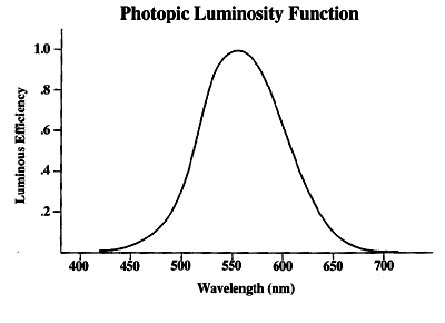

guyburns said:
Candelas, and therefore all related light measurements, at the most fundamental level are measuring Watts
Candelas and watts are related, but ratio depends of wavelenght and is called luminous efficacy. (https://en.wikipedia.org/wiki/Luminous_efficacy)

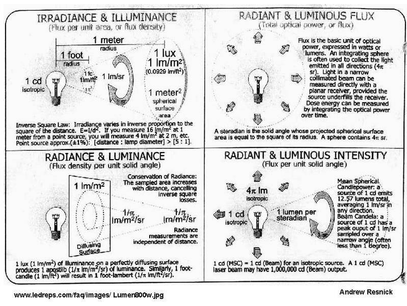

A picture is worth 1000 words:
http://www.dfisica.ubi.pt/~hgil/Fotometria/HandBook/ch07.html
Does this help? Isotropic sources make a lot of the above seem needlessly complicated. Things are more interesting for directional sources.
