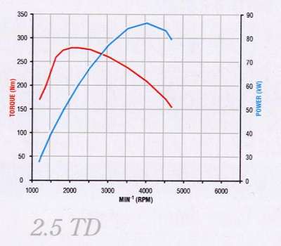

In some engines, yes, power increases proportional to RPM within a certain rev range, as torque remains constant. But there are limits where gas flow and other things limit the power.
This is the "Power Curve" graph.
To make an engine more easy to use, often an engine's gas flow & electronic control is altered so the torque drops off as the revs rise.

No that's not correct. Car engines are not "ideal" engines. The power they produce isn't linear. They have a power curve as Al_ has stated. Here is an example...
Source: http://www.fordscorpio.co.uk/images/powertdi.jpg
Note how the power curve in blue has a peak at 4000rpm for this engine.
so what happens at low RPM in the same gear? Is the power kept the same and torque increased as it is inversely proportional to RPM so will increase as the RPM decreases? Or does the power at the engine decrease with RPM and torque kept constant at the engine?
The graph shows how much torque and power an engine can produce an any given engine rpm. Remember the actual torque and power depend on the throttle setting which controls how much fuel/energy is available. So the engine could be operating anywhere below the curve.

Typically as the car goes faster there comes a point where the rpm goes over the top of the peak in the power curve and power output falls. Changing up reduces engine rpm bringing the engine rpm back to nearer the peak increasing power.
As the car goes faster there is more air resistance so FD increases and there is less power available for FI, meaning that the acceleration reduces. eg most cars accelerate fastest at slow speeds when air resistance is lowest.

I believe the drop in power after the peak is mainly due to issues with the way engines breath. Can't get the fuel/air in and out fast enough. Something like that.
