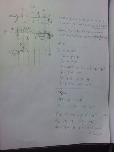

Given the simple beam in the picture, draw the moment and shear diagram.
point loads = qa
distributed load : q on a length of 2a
where M - is the moment, T - is the shear
I draw the shear diagram, found all the ractions but I'm stuck at the moment diagram.
On section AB, is the qa load giving any moment value? I know that the moment diagram value is the area of the shear diagram, but for example, on AB, the area would be 2qa^2, but the moment value seems to be qa^2. I'm a little confused here.
What i did so far is in the attachament.
