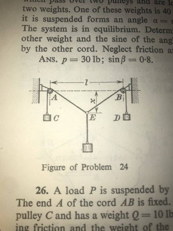

The cord CAEBD passes over pulleys A and B of negligibly small diameter. Two weights of p lbs each are attached to the ends C and D of the cord, and a weight of P lbs to the point E of the same cord. The points A and B are at the same level and the span AB is ##l##. Determine the distance ##x## between the level AB and the point E if the system is in equilibrium, neglecting friction and the weight of the cord.
Answer:
$$x=\frac{Pl}{2\sqrt{4p^2-P^2}}$$
$$\sum \vec{F}=m\vec{a}$$
I've deduced that the weight of each weight p is half that of the weight P, and likewise P= 2p.
Here's the diagram for the problem:
As you can see, the length x is equal to the height of the triangle AEB.
I know that if a triangle has equal sides of length ##a## and a base of length ##b##, the height h can be simplified to:
$$h=\frac{1}{2}\sqrt{4a^2-b^2}$$
I just don't see how to find the sides ##a##, which are AE and EB in this example, in terms of the weights, and the proportionality/relationship between the weights and these lengths.

What I got was that the x-components cancel and you have for the y direction:
p lbs + p lbs = P lbs
I also see that the sides AE and EB are equal to ##\frac{\sqrt{4x^2-l^2}}{2}##.
Does 2p = -P?

Try to answer these questions in sequence:
  1. What is the tension in the vertical section of cord above the left hand weight?
  2. What is the tension in the angled section of cord from the left hand pulley to the knot where the cords meet?
  3. What is the tension in the vertical section of cord above the central weight?
  4. What forces act at the knot?
  5. What are the vertical components of those forces?
  6. What equation represents the vertical balance of forces at the knot?

I got ##T_{AC}=p##
How do you find number 2? I don't quite understand how the forces of p and the centerweight are interacting.

I'm not sure how to solve the problem as there are no angles for me to find the components of the tensions in BE and AE with.
You don't need the angles as such, just their sines and cosines. You have those in the form of x and L.

The angle respect to a vertical line (direction of the gravity force) formed by the sections AE and BE of the rope makes the magnitude of the tension of each be greater than half the weight of the central mass P.
The smaller height x becomes respect to distance l, the bigger those tensions become, up to the theoretical value of infinite if x could become zero.
Rather than having those pulleys and equal masses p keeping the system in equilibrium (the big mass P stays suspended in midair), imagine you and a friend would be pulling from ropes AE and BE each.
You would soon note that the higher you try to keep mass P, the harder each of you would need to pull the rope.
You would never be able to keep sections AE and BE on a horizontal line, certain triangle ABE would naturally form, no matter how hard you both pull.
You could also feel that allowing the mass P to descend would reduce the individual pulling effort, which only then would tend to be half the weight of mass P.
Therefore, for keeping a triangle ABE of proportions similar to the one shown in the schematic, each mass p must weight much more than half the weight of mass P.

Is p the vertical component of force of the in each of the two sections of the rope AE and BE?
If it is that means that P would be equal to ##2psin\alpha##, where ##\alpha## is the angle between AE and CE, equal to the angle between BE and DE.
No.
You got the tension in AC correctly as being p. How should that relate to the tension in AE? Think about the pulley at A. If the two tensions are not equal, what will happen?
Likes Lnewqban
haruspex said:
No.
If the two tensions weren't equal, there would be a net force and therefore acceleration in the system.
P would still be equal to ##2psin\alpha##, ##\alpha## being the angle between the AE and CE which is equal to the angle between BE and DE, right?
I finally figured it out, I'll post this for anyone stuck on a similar problem.
$$y:T_{AC}=T_{BD}=T_{AE}=T_{BE}=p$$
$$-P+2psin\alpha \Rightarrow P=2psin\alpha $$
$$psin\alpha \propto x; pcos\alpha \propto \frac{l}{2}$$
$$P=2p(\frac{x}{\sqrt{x^{2}+\frac{l^{2}}{4}}})$$
$$\frac{P\sqrt{x^{2}+\frac{l^{2}}{4}}}{2p}=x\Rightarrow P^{2}(x^2+\frac{l^2}{4})=4p^2x^2$$
$$\frac{x^2}{x^2+\frac{l^2}{4}}=\frac{P^2}{4p^2}\rightarrow x^2=\frac{P^2x^2+\frac{P^2l^2}{4}}{4p^2}\Rightarrow x^2(4p^2-P^2)=\frac{P^2l^2}{4}$$
$$x^2=\frac{P^2l^2}{4(4p^2-P^2)}\Leftrightarrow x=\frac{Pl}{2\sqrt{4p^2-P^2}}$$
