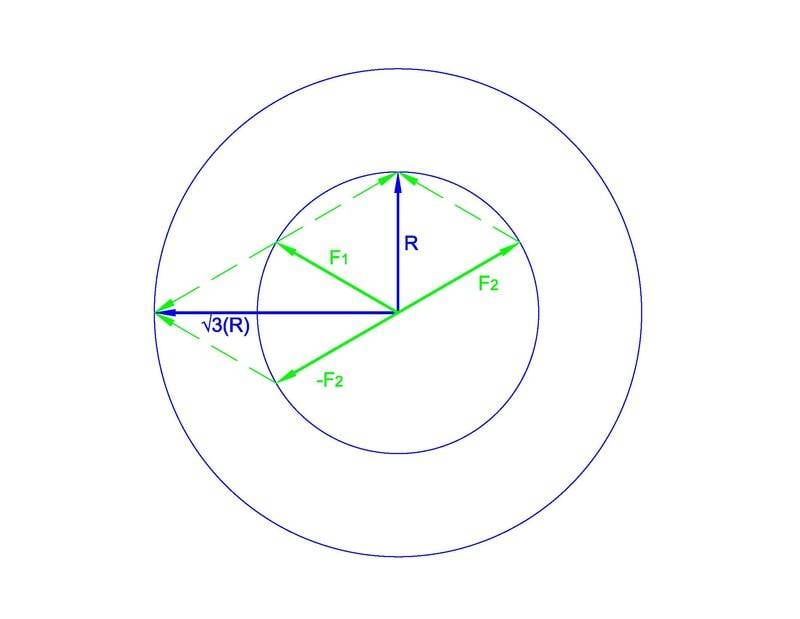

Welcome, @DIANAWIELT !
This diagram shows that those angles are not cancelled out.
Likes MatinSAR

@DIANAWIELT … but please note that @Lnewqban's diagram assumes the forces are equal in magnitude. It is not clear whether you are supposed to assume that (unless you missed that out in post #1).
