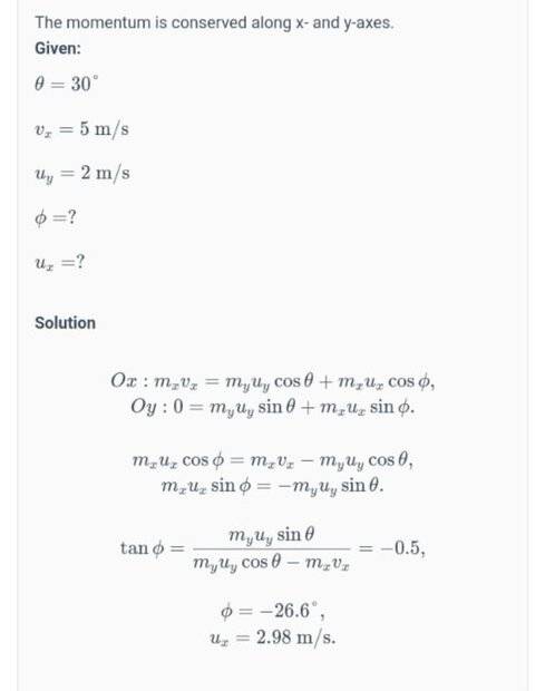

A pool ball X of mass 0.3 kg moving with velocity 5 m/ s hit a stationary ball Y of mass 0.4 kg . Y moves off with a velocity of 2 m/ s at 30 ° to the initial direction of X . Find the X and it's direction after hitting it.
momentum formulas
First i think the correct solution to the problem is
But my friends argue that it is not what i did , i am confused we didn't see the whole chapter on momentum in class, (Youtube thank you)
here is what my friends say :
(0.3×5) + 0 = (V×0.3)+(0.4×2)
and they get they a final speed of 2.33 m/s , with negative direction.

I think you are correct. Can you guess what kind of collision your friends' equation describes ?

@kuruman : ball Y moves off with x component velocity in the positive direction ...

Consider that it is momentum conservation in one single direction: a central collision. And elastic (check !)

You may be missing the point of @BvU's question.
You asked how come your friends did not need energy conservation. The reason is that they treated it as a head-on collision. On that basis they did not need to consider energy; there was enough information to find X's final velocity (and to calculate the energy change).
As a 2D collision, we have one more unknown, so a second equation is needed.

I'm coming back to post #1, checking the math and such :rolleyes:

Doing the math gets me 2.33 m/s in the positive direction....
El foolish Phenomeno said:
the correct solution to the problem ...
I get -26.36##^\circ## and 3.00 m/s. Nitpicking ?

Check: ##T_{in} = {1\over 2}m_x v_x^2## = 3.75 J and
##T_{out} = {1\over 2}m_x \; 2.33^2 + {1\over 2}m_y u_y^2## = 1.62 J, so not elastic (my bad suggesting that in post #6 o:) ).
and for the correct result ##T_{out} = ## 2.15 J, not elastic either.
If you want to get some practice, determine ##u_y## for the case of an elastic collision with ##\theta = 30^\circ## :smile:

Yes. The mistake in the given answer was in rounding 0.49555.. to 0.5 in the preceding line.
So it's nitpicking allright. Given data are only one decimal ...
However, my rule is not to round off intermediate results unnecessarily.

Not nitpicking at all. The answer should have been given as either 26° or 26.4°, not 26.6°.
