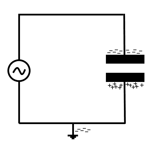

Please help me with this. I am having a hard time understanding the role of displacement currents in a circus. The common knowledge is actual current is the movement of electron in a circus. Now, if there is a gap and an AC source, there would be an electric displacement field and a displacement current in that gap. But that displacement current is not the movement of electrons. Then what happen with the electrons once they reach one end of the gap? Where do they go? And what happen to the ground electrode of that circus if there is no electron to ground?

So if the two edges work like a capacitor then with an AC source, it would be like the continuously charging and discharging cycles of the capacitor. I can imagine that without a grounding conductor. But then if the system is ground, I mean the role of grounding is to lead exceed electrons through a conductor to the ground right. Then if there is a lost of electron on one side, how can the process of recharge continue?
Please see the picture to understand what I mean.

You basically mean that there is a leakage current to/from the ground (electrons that come from or go to the ground). Yes this is true, but for small frequencies and with the simplifying assumptions made in circuit theory it is neglected. Only if you want to do complete field analysis of the circuit, you take into account such currents.
