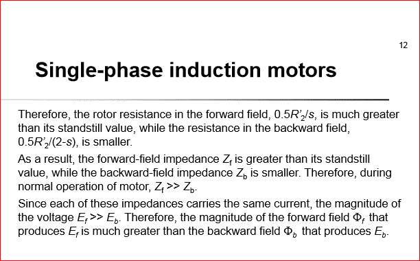

I studied that as the single phase motor speeds up the backward induced field currents are larger than the forward field currents. So , the corresponding opposing rotor mmf causes backward field to be greatly reduced whereas the smaller forward currents leads to enhancement of forward flux wave..
I am not getting this fact as if the backward current is higher so even the backward flux should be greater . Then , on what basis the forward flux is greater?
The backward field currents has a lower power factor whereas the forward currents have higher power factor .[/B]

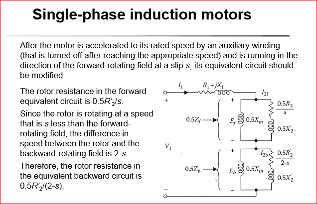

Clearly something cancels out nearly all of one of those counter-rotating fluxes.Here's a link with some mathematics trying to explain it
but to me he does it in a roundabout manner
http://ee.lamar.edu/gleb/tps/Lecture%2003%20-%20Special-Purpose%20Motors.pdf
Since, in that equivalent circuit, resistance is where torque is produced , most of the torque will appear in the upper resistor

Hmmm... see if these words help you accept what we empirically know to be true... and what the author cited above asserts:
Remember an induction motor is essentially a transformer with shorted secondary.
Since in a transformer secondary mmf cancels primary mmf, backward component of current in rotor cancels backward component of primary mmf...

I'm still trying to reconcile what happens at the rotor... a physical picture not an equation
The key to an intuitive picture i think lies iwith envisioning the rotor bars and their relation to the stator poles.
I might try to draw something when get back home...Envision a simple two pole machine with one turn stator windings, one per pole at 12 o'clock and 6 o'clock.
Freeze frame your thinking to instant of maximum flux, stator voltage zero crossing
Next , envision the rotor bars in plane 3 o'clock-9 o'clock; clearly they're perpendicular to flux so link it all
and they're the ones that cancel stator flux
next envision the rotor bars in plane 11:59 o'clock-5:59 o'clock not quite aligned with poles
they link very little flux
but what happens if the rotor is turning slowly ?
Flux linked by 3-9 o'clock loop is not changing
but flux linked by 11:59-5:59 o'clock loop is changing considerably.. Lenz will try to do something about that...
