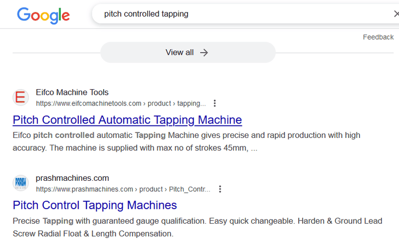

A Google search turned up lots of hits -- maybe try the same search?
