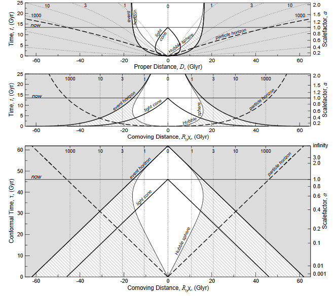

I've only recently jumped down the rabbit hole of physics. A social media post on time dilation four months ago got me hooked. Not only has it been a great way to exercise my brain, some of its discovery has been entertaining. Unfortunately my primary source of understanding came from the internet. At first I accepted whatever showed up from a search, as I learned more I started to questioning those results. I would like to know the scientifically accepted size of the observable universe. I have found answers ranging from 93 billion light years in diameter down to 26.6 billion light years in diameter. Not only is there a large discrepancy between the size, even a novice such as myself is able to dispute a couple fairly easily.

The confusion probably arises out of the fact that "now" is an English language term that is not well defined in cosmology. You have to be considerably more specific. If that sounds weird to you, well ... welcome to cosmology. Keep reading and you'll get it after a while. You have to be sure you understand just what it is that is being described as having some specific diameter.
The "accepted" figure is 93 billion light years in diameter "now" but the objects that emitted the light that we say is that far away "now" were nowhere near that far away when they emitted the light.

The subject can be confusing when you first encounter it. I agree with @phinds that you need to be careful and make sure you understand what precisely is meant by each statement you use.
You started well enough with defining observable universe. But further down the post it gets a bit murkier.
Let's go over each content-bearing statement.
HankDorsett said:
The most distant object we have ever observed is a Galaxy that is estimated to be 13.3 billion light years away. Because of this observation I would say that are proven observable universe is 26.6 billion light years in diameter.
The most distant would be the cosmic microwave background radiation. That's just the most distant galaxy, whereas there is quite a bit of space seen further away, at the time when galaxies hadn't yet formed (but filled with gas). However, it's beside the more important point addressed below.
Here we have a citation of distance, but no indication what distance is being used. There is a whole lot of different distance measures used in cosmology, where their use is dictated by certain measurable properties, but doesn't necessarily resemble anything like the everyday meaning of distance.
In particular, the distance cited above is 'light travel time distance'. It is what you get if you multiply the time it took light to arrive to us to be observed times the speed of light. This would give you something very much like the everyday notion of distance, if not for the fact that we don't live in a static universe.
If you imagine an emitter at some initial distance ##D_{initial}## from the observer, sending a light signal in a universe that is not undergoing expansion, then by the time ##t## the signal arrives, it will have traveled ##D_{travel}=ct##. The object at the moment of reception is at distance ##D_{final}##. Because the universe is static, all distances are equal: ##D_{initial}=D_{travel}=D_{final}##.
But, if the space, through which the light signal is travelling, is expanding, these distances will differ. After emission at ##D_{initial}##, the signal begins to approach the observer, while the emitter is receding from its initial spot. After time ##t=D_{travel}/c## it arrives. By that time, the emitter has managed to recede to ##D_{final}##. Now, ##D_{initial}<D_{travel}<D_{final}##.
So, if asked what is the distance to the observed object, we can say it is either of the distances, and each will have a different numerical value, but also mean different things. ##D_{initial}## is where it was at emission, ##D_{final}## is where it is now (in the sense that, if you could stop the expansion and take a measuring stick, that's where you'd find it). The distance ##D_{travel}## doesn't have any concrete physical meaning that'd map to our everyday understanding. The emitter neither was nor is at that distance.
So, after this long-winded exposition, the point would be that one should not use the light travel time distance as a measure of the size of the observable universe, because it's essentially meaningless, if convenient in some scientific contexts.
It's also, perhaps, important to note that the light travel distance is not a direct observable - you can't ask a photon how long it's been going for. Neither are any other of the distances. The main direct observable is the redshift, with all distances derived with the use of cosmological models. So, providing you do want to make a statement on the size of the observable universe, you do have to settle on a derived value.

HankDorsett said:
I believe that 93 billion light year number came from a study that estimated the size of the known universe. The study estimated where the farthest galaxies could be after billions of years of expanding universe. I can't see how this could be considered observable if the only thing we have this far out is an estimated location.
That's precisely the meaning of the reported size. As explained earlier, it's the ##D_{final}## distance.
Now, you could argue, that you'd rather use the ##D_{initial}##, in which case the universe would be some 88 million light years across. But that seems even more conceptually problematic, as I think you'd agree. The ##D_{travel}## has no physical meaning, and as such is the worst measure to use.
Whereas ##D_{final}## does map, at least partially, to what we mean by where something is. In particular, you can modify the question, and instead of 'how far is the object I see after time ##t## since emission' you can ask: 'how far did my signal travel to after time ##t## since emission' - which is the same number.

The issue here is that when talking about 'farthest observed data' or 'observed diameter' you are talking about distances that are 1) ambiguous, 2) derived.
The OP had the same issue, which I tried to address in my long-winded post (#4).
Tl;dr;
The observed quantity is not any kind of distance, but the redshift. It carries with itself information about a number of distances, some more physically meaningful than others, that can be extracted with the use of an expansion model.
In particular, it's possible to extract information about where the object was at emission, or where the object is now. It's our decision to report the size of the observable universe as it was then or as it is now.
Arguably, the latter is more resembling of the everyday concept of 'size' than the former, so it stands to reason it is used when reporting the size of the observable universe.
This becomes a bit more apparent if we invert the emitter/observer and have our spot in the universe be the emitter, while some alien in a faraway galaxy is the observer. There were some physical processes occurring at our location in the early stages of the universe that are currently observed by some aliens that are now at a distance of 46 Glyr. They can see our spot despite being 46 Glyr away, so it's a fair thing to say that the observable universe is 46 Glyr in radius.
In any case, reporting the distance now is the convention that has been adopted.

The size of the observable universe is given by the proper distance light has since the very early universe been traveling away from us up to now. As you can see https://www.semanticscholar.org/paper/Expanding-Confusion%3A-Common-Misconceptions-of-and-Davis-Lineweaver/4b3aa8dca646dfbe389b39b9b894fdf3973115bb/figure/2 this light is now about 46 billion light years away from us. This definition clarifies that we can't see a galaxy which is at the horizon of the observable universe. We just can calculate the distance now to the horizon from our knowledge of how the universe was expanding since then.
I think this description misses a step: why is the size of the universe given by light which traveled from our location? If we're observing, why aren't we using a definition that relies upon what the receiver sees instead?
The definition you gave works because the situation is symmetric: because the universe is homogeneous on large scales, the light which was emitted from our location billions of years ago and traveled to some other galaxy out there behaves in the same way as light from that other galaxy which traveled to meet us. It's just that it's a little easier mathematically to work in coordinates where the origin of the coordinate system is the emitter rather than the receiver.
I can't see the the difference because of the symmetric situation as you said. Why shouldn't I prefer the proper distance now to the particle horizon? This is easy to be seen from the space-time diagram which shows how the distance to the particle horizon and hence the size of the observable universe depends on the expansion of the universe till now.
Perhaps I didn't get your point.
For the sake of completeness the size of the observable universe is larger than shown in the diagram because neutrinos are traveling since the very beginning, about 380000 years before last scattering. But I have no idea how much the correction would amount.

  • #31
The diagram goes all the way back to the singularity.
It's better visible on conformal time vs comoving distance version:
Where the CMB emission is just below the mark of scalefactor = 0.001. The difference in proper distance is not large, some hundred million light-years.
The point in @kimbyd 's post is that it's not immediately obvious that the particle horizon and past light cone are symmetrical reflections, especially not if one thinks in terms of proper distance (first graph above), so it requires clarification as to why we care about outgoing signals instead of incoming.
  • #32
Ah I see, thanks. Yes the conformal time diagram clearly shows the symmetry.
