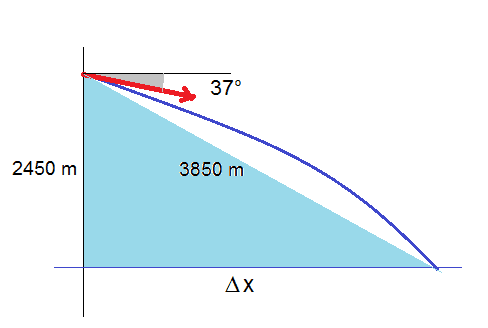

So I begin with a triangle.
Hypotenus = 3850 m. angle opposite hypotenus is 90 degrees. I find the top angle to be 53 degrees, because the plane is coming down at angle 37 degrees. That leaves angle at the drop to be 37 degrees.
Does everything seem right so far?
The length of the 37 degrees angle is 2450 m - x, but I find it using law of sines.
3850 m / sin(90) = x / sin(37)
I find it to be 2316 m, and using pythagoras I get 3075 m to be the length for angle 53 degrees.

I had a very difficult time understanding your work. Can you tell me what you calculated for the horizontal distance that the bomb traveled?
3075 m.
Using law of sines with 3850m/sin(90) = x/sin(53) gave me x = 3075 m
You know that the displacement is 3850. And you know that the height is 2450 m. So from that alone you can calculate the horizontal distance that it traveled. The angle of that triangle is not 53°. The initial angle of the bomb starts out as 53°, but it changes continually as the bomb falls.
Edit: I should have said that the angle of displacement is not 53°. It starts out as 53° but changes continually - getting smaller and smaller - as the bomb continues on its path.

Make a drawing and show that triangle. I think you want to find the maximum displacement in the horizontal direction, but you use the wrong angles. It is the initial velocity that makes the angle 37° below the horizontal.
No. See the picture. The red arrow represents the initial velocity of the bomb, the same as the velocity of the plane. The blue line is the trajectory of the bomb. Δx can be found from the light blue triangle using Pythagoras.
Likes TomHart
That picture is worth a thousand words.

Sorry everyone I forgot to note important information in the OP.
The question is:
A ww2 era dive bomber is being used to drop food and supplies to outposts on remote mountaintops. During one such drop, the bomber descends with velocity v directed at an angle of 37 degrees below the horizontal. The cargo is released at an altitude of 2450 m and reaches intended dropzone with a displacement of 3850 m. What is the speed of the bomber when it releases its cargo?
So since the bomber is on a mountain top, but altitude means from sea level right, so the [itex] \Delta y [/itex] must be 2450 m - x, correct?
http://i.imgur.com/otPRfTm.png
What can I do with the given information to complete my triangle? So far I have one angle, 90 degrees, and its side is 3850 m long, then I have two more sides, [itex] \Delta y [/itex] and [itex] \Delta x [/itex] and their angles are uknown. How do I proceed from here?
Since that would leave you with inadequate information, you should take it as meaning relative to the mountaintop.
Thanks for the info. It led to me obtaining the answer. Wow this question was not half as complicated as I thought it would be.
