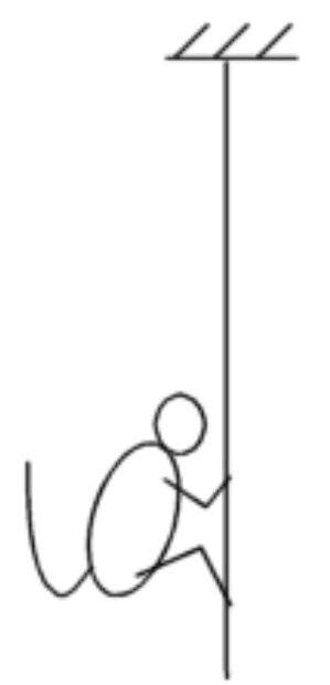

What is the tension in a rope when a monkey accelerates up?
In summary, the tension in the rope will be equal to its weight, mg. When the monkey accelerates upwards with acceleration a, the tension in the rope will increase to mg + ma. This is because the monkey's force of ma in the downward direction is countered by the rope's force of ma in the upward direction, according to Newton's third law. However, when the monkey is hanging or climbing at a steady pace, the tension in the rope will only be equal to the monkey's weight, as the only upward force on the monkey is the upward friction of the rope and the only downward force on the rope is the downward friction of the monkey. Therefore, the tension in the rope should not be shown on the monkey's free

@Steve4Physics (taking up as +ve)
1. If tension is the pair of forces which stretch the rope then why do we show in diagrams the tension inwards?
2. Tension is the force applied by monkey on rope. It is pair of outward forces. Magnitude wise ##T=F_{MR}##. But vectorially ##-T=-F_{MR}##.
Can I say ##T=F_{RM}##?
3. What is the meaning of each?
##-T=-F_{MR}##.
##T=-F_{MR}##.
##-T=F_{MR}##.
##T=F_{MR}##.
##-T=-F_{MR}##.
##T=-F_{MR}##.
##-T=F_{MR}##.
##T=F_{MR}##.
1.
It depends what body is being considered in the FBD. Whether it is something pulled by an end of the rope or the rope itself, it will point away from that body.
2., 3.
'T' is being used to mean two things here.
On the one hand it can mean the tension, which exists everywhere along the rope acting on each short element as a pair of opposing forces rather than as a single force. In this meaning, direction is either outward from each rope element (tension) or inward on it (compression).
On the other hand, it can mean one of that pair at an end of the rope, and it is up to you to decide which of the pair it stands for. When you write a force equation involving tension you are necessarily taking this second view.
I chose above to consider it as the force the monkey exerts on the rope.

Did you read the link in @Lnewqban;s Post #26?
Tension is referred to as a ‘force’ but is a bit more complicated than a simple force.
Say we have rope, AB represented as A------B .
Pull A left with a force of 10N and pull B right with another force of 10N.
10N←A------B→10N
The system is in equlibrium and we have an ‘inwards force’ inside the rope, which stops A and B moving apart. This ‘inwards force’ is called the tension.
At the ends, A is being pulled right by tension and B is being pulled left. We say the tension (inside the rope) is T=10N and we represent it by a pair of inwards arrows:
10N←A→--←-B→10N
The forces at point A are: 10N←A→T
The forces at point B are: T←B→10N
(Note, the external applied 10N forces are not called tension, though they are numerically equal to the tension here.)

Shown below is my diagram adapted from @vcsharp2003's. We know that there are two items that exert a force on the monkey, the rope and the Earth. The forces are shown as arrows in the diagram. You can label them any way you wish. We also know that the monkey is moving up at constant speed. That's all you need to answer the question.

There is no difference, 'is equal to' means having the same value.
But remember, different vectors can have the same magnitude but the vectors will be unequal if their directions are different.
##\vec T## is the tension acting upwards on the rope (where it is hed by the monkey).
##\vec F_{MR}## is the frictional force acting downward on the rope.
The rope is in equilibrium. To be rigorous we should write:
##\vec T+ \vec {F_{MR}}## = 0
which gives
##\vec T = -\vec {F_{MR}}##
Less rigorously we could write this as:
##T = -F_{MR}##
In terms of magnitudes we can write:
##|T| = |F_{MR}|##
If we are using '##T##' and '##F_{MR}##' to represent magnitudes, we should state this to avoid confusion/ambiguity. Then we can write:
##T - F_{MR}=0## which gives
##T = F_{MR}##.
We could also use the unit vector (##\hat k##) but this might be a bit over-the-top for this type of problem.

In the absence of a diagram, it can get confusing to understand the question. The scenario that I had in mind while looking at the question is as below, where frictional force makes sense.
I'm not sure if the scenario of question is different from what I thought.
That is still answered by my last option, consider the piece of rope the monkey clutches as part of a monkey+rope piece system.

If the rope breaks, the energy of the external forces did the destructive work.

To @rudransh verma :
The important thing to remember about tension in a rope is that a force is associated with it. To find its direction, first you need a system on which this force acts. Once you have defined the system, the force due to tension acts along the rope or string in a direction away from the system. In short, you cannot push with a rope.
For example, in the climbing monkey problem we can choose to define the monkey as the system (see post #48.) The force due to the rope tension is up and away from the monkey. We can also choose as our system a 10 cm piece of rope above the point of contact with the monkey's hand. In that case, there is a down force on the 10 cm piece of rope due to the monkey's hand (equal and opposite to the one exerted by the rope on the monkey and away from the system), and an "up" force, also away from the system exerted by the rope that is above the 10 cm system. We can also choose a piece of rope of any length as the system. There will be two forces at each end of the system, both pointing away from the system.
At this stage, I think that's all you need to know to figure out the direction of the force due to tension in order to use it in free body diagrams. Knowing the details of the molecular forces that give rise to this force is not necessary for drawing and interpreting FBDs just like it is not necessary to know exactly how a car engine works in order to drive one to a friend's house. Defining the system before you attempt to draw the force due to tension is as important as knowing what a car looks like before you get in it.
