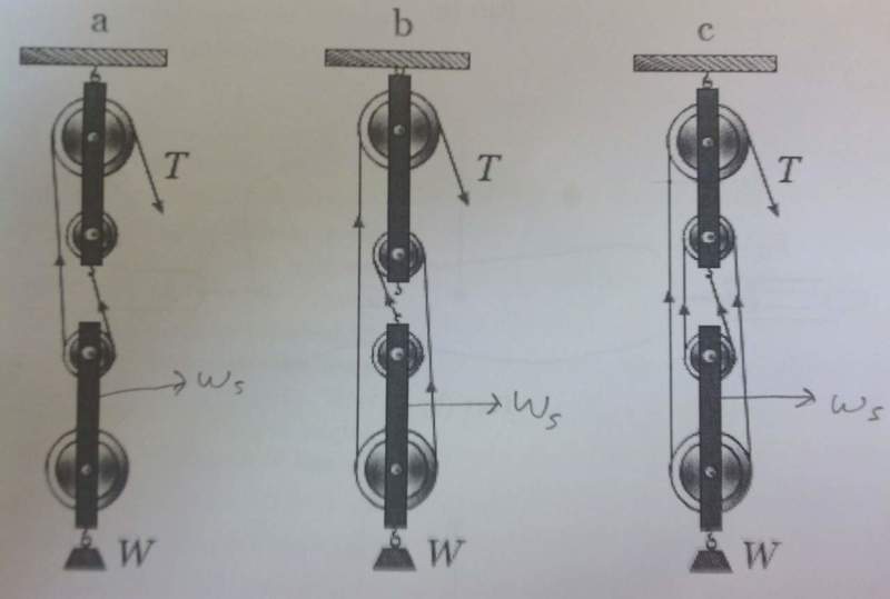

Calculate the tension T in case a, b, and c if acceleration = 0.
Ws = weight of the bottom pulley
W = weight of the weight
mg - T = m*a
For a, it just seems like T = Ws + Wm since the bottom pulley is connected to the top pulley.
For b, the force is being redirected by the pulley.
For c, two masses are balanced along the pulley yet only the tension of one mass is measured.
