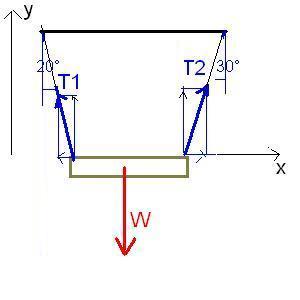

A 1200 kg steel beam is supported by two ropes. Rope one is 20 degrees off of the vertical, and rope two is 30 degrees off of the vertical. What is the tension on rope two? (Answer should look like '2300 N'.)

The beam is in equilibrium. What does it mean on the sum of forces acting on it? Draw the FBD.

The beam isn't accelerating in any direction so the sum of the forces acting an any direction is zero. eg The horizontal components of all forces sum to zero. The vertical components of all forces sum to zero. Write these two simultaneous equations.

In which direction is W working ?
vertically
Means T1y + T2y + W = 0

I would write the two equations as:
T1y + T2y - W = 0
and
T1x - T2x = 0
However I don't get the answer T2 = 2300N.

Pity there isn't a drawing. I initially imagined a beam supported from the ends like this \___/ but I think that would imply a non uniform beam (otherwise the angles would be the same). So I assume the beam must be hanging like this __\/__ Can the rsrunner please confirm?
Would you hang a heavy beam at its centre? Supposing the beam is horizontal the setup migh look like in the figure. The problem did not state that the beam was uniform.

OP doesn't say ropes are attached at the ends
True... So the beam can be uniform, but it does not matter.
Wouldn't a very non uniform beam allow T2 to be 2300N?
##11760 \; \sin(20^\circ) = 4022##

I don't see how. You can have the beam at an angle, non-uniform density, ropes attached anywhere - you still have two linear force equations containing only two unknowns, the tensions. The torque equation then puts constraints on points of attachment, etc.
Having thought about it some more I agree.

That was to support my post #12: with one rope at 20 degrees and all the weight on that one, T2 needs to compensate the horizontal component only. Still, that's over 4000 N. You'd need a very long rope to get to that minimum for a horizontal bar. Gets better if bar is at an angle and the light end almost touches the ceiling...
I thought that was a global minimum/extreme case. Not so:
Interesting excercise to work out the minimum T2 for T1 at 20 degrees and T2 attached so that the bar is in equilibrium (haru post #20). Turns out to be easy: 70 degrees. With the same 4022 for T2 !
