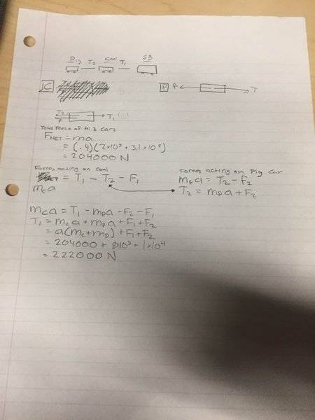

A tugboat pulls two barges down the river. The barge connected to the tugboat, carrying coal, has an inertia of 2.0 × 105 kg, and the other barge, carrying pig iron, has an inertia of 3.1 × 105 kg.The resistive force between the coal barge and the water is 8.0 × 103 N, and the resistive force between the pig iron barge and the water is 1.0 × 104 N . The common acceleration of all three boats is 0.40 m/s2. Even though the ropes are huge, the gravitational force exerted on them is much smaller than the pulling forces.What is the tension in the rope that connects the tugboat to the coal barge?

i though my reasoning was pretty straight forward on why i approached it that way.the tension would be on the rope (or whatever is pulling it) in between the tug boat and the coal boat. this would make the mass 2.0x10^5 by the acceleration of the whole system (0.4) yet you'd need to account for water resistance on that boat which is 8.0 × 10^3 N

yes I've sketched and drawn free body diagrams, would the other rope attached to the coal barge be creating a force of friction too? meaning my solution would need to look something more like
T=( 2.0x10^5)(0.4)- (8.0x10^3+3.1 × 105 )
=-238000N

i already solved it on my own
Just out of curiosity, how did you? Since it appeared you were not quite on track?

#3 and #4 needs to be justified.
The best-practise is to do the free body diagram for the pig-iron boat as well, then solve the system of simultaneous equations you get... remembering what I told you (probably you, certainly I've told @emily081715 ) in other threads how you should do all the algebra using symbols first, then plug the numbers into the final equation.

Well done - please share so other people will benefit from the insights you gained.
Likes I like Serena
It goes like this then:
fbd for coal barge: T2<----fc<----[mc]---->T1
(1) ##T_1 - T_2-f_c = m_ca ## (fc is the drag on barge c)
fbd for pig-iron barge fp<---[mp]--->T2
(2) ##T_2 - f_p = m_pa##
Strategy: solve for ##T_2## in (2) and sub into (1).
##T_2 = m_pa + f_p## ...
##T_1 - (m_pa + f_p) - f_c = m_ca \implies T_1 = (m_c+m_p)a + (f_c+f_p)##
... which is what you got. Well done.
It's pretty much what you did - you just put the fbd's next to each other where I put them in a list.
