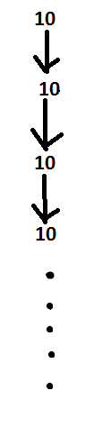

Given the above algorithm, I want to calculate the time complexity.. (Thinking) The cost of the line $2$ is $1$.
The cost of the line $3$ is $1$.
The cost of the line $4$ is $4$.
The cost of the line $5$ is $2$.
The cost of the line $6$ is $T(\lfloor{\frac{n}{2} \rfloor})+1$.
The cost of the line $7$ is $2$.
The cost of the line $8$ is $T(\lfloor{\frac{n}{2} \rfloor})+1$.
The cost of the line $10$ is $1$.
But.. how can I find now the recurrence relation, that describes the time complexity? (Worried) (Thinking)

Observe that you recurse at most once, since it's an if/else condition. So in the worst case, you have:
$$T(n) = T(\frac{n}{2}) + C$$
where $C$ consists of all the constant time operations, we will aggregate them into a single constant for simplicity. Solving this for $T$ yields:
$$T(n) = \log_2(n) + k$$
for some constant $k$. Thus, in the worst case:
$$T(n) \in O(\log{n})$$

A ok! So, can I formulate it like that? (Thinking)
When high=low-1, we count the cost of the following lines:
$$2,3$$
So, the time complexity is $2$ in this case.
In this case, the array has $0$ elements, so $T(0)=2$.
When $n=high-low+1$, we count the cost of the following lines:

Will the resursion-tree be like that?
If so, for which value of $n$ will it end? And how can I find the last value that it will take? (Thinking)
It would help if you specify at each level the fraction of $n$. (Worried)
At the top level you are calculating for $T(n)$.
One level down for $T(\lfloor\frac n 2\rfloor)$.
Etcetera, until we get to $T(0)$ for which the cost is $2$.
To get a sense of this, perhaps we can pick an example for say $n=8$. (Mmm)
And perhaps another one for $n=11$.
