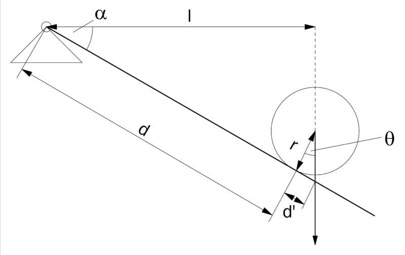

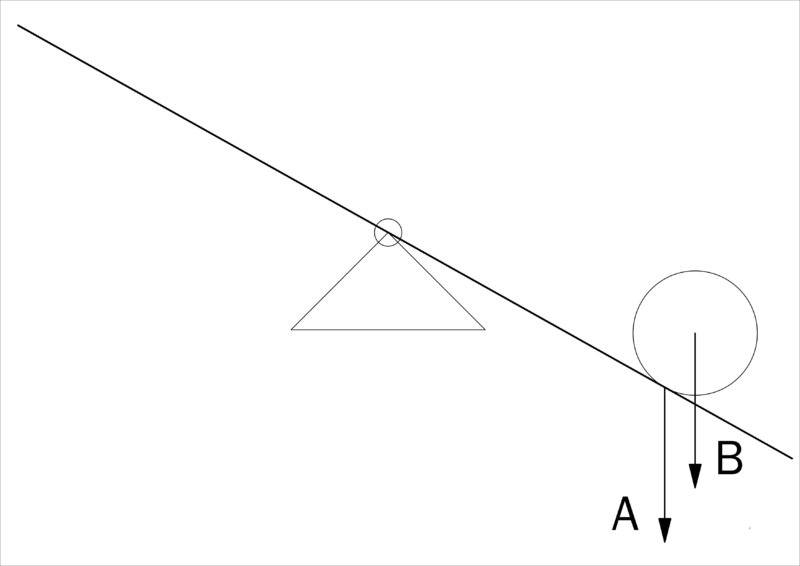

In the attached schematic, assume the load is fixed (by glue or screw etc.) to the see saw. Which force would you use to calculate the torque generated by the load?
In order for the seesaw to move anticlockwise in presence of the wall, then it have to break the force that attache the object to it.
so i think force A will be vital in deciding if the seesaw will move or not because if it exceed the torque the seesaw will not move at all.

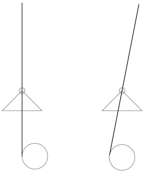

Same scenario with the load fixed and without wall to the seesaw: Which of the two drawings you think will be the final position?

I think you are assuming that there is no force on the other side of the seesaw, so in that case the figure on the right will be right because the object centre of gravity will be directly under the centre of the seesaw
Starting to get what you mean
you mean the forces should be calculated as acting on the centre of the object
Yes. So regarding your first calculation (without wall and the load not sliding, because it is attached to seesaw somehow), you have to take into account the increase of the lever due to the inclination, since the force is "shifted upwards" by the radius of the load.

I think it would be easier to calculate the distance ##d'## as indicated in the image attached. You just need to know the value of ##\theta##.

yes ... if the object was also a cylinder with 0.15m radius that have mass of 5kg then the force affecting the torque will be the sub-vector of gravity perpendicular to the line between the centre of the seesaw and the centre of the object = cos76 x 5kg x 9.8m2 = 11.85 N
Sorry, I got lost. But what I was thinking about was (by the way ##\alpha=\theta##):
$$l=\left(d+\underbrace{r\;tan\alpha}_{d'}\right)cos\alpha \approx 0.59$$
$$mgl =29.17\;Nm$$

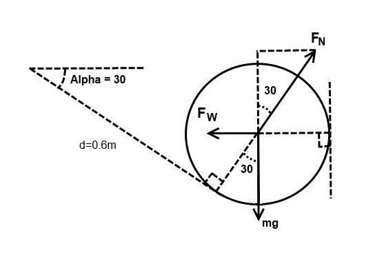

I drew a FBD of the cylinder and calculated the clockwise torque as follows...
The normal force on the cylinder from the beam is mg/cos(30) at 0.6m from the pivot. That works out at 34Nm. The anticlockwise torque is 49Nm so I believe it rotates anticlockwise.

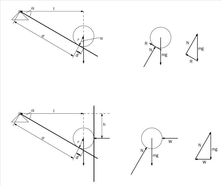

Not too much time today, sorry (compare the symbols with the schematic):
Scenario 1 (without wall, the ball attached somehow to the seesaw - you didn't mentioned that in your first post, but I assumed it):
$$mgl =29.17\;Nm$$
$$N=mg cos\alpha$$
$$Nd = 25.49\;Nm$$
$$\rightarrow mgl \neq Nd$$
If the radius ##r## of the load would be zero, the two expressions would be equal.
Scenario 2 (with wall):
$$l=\left(d+\underbrace{r\;tan\alpha}_{d'}\right)cos\;\alpha \approx 0.59$$
$$mgl =29.17\;Nm$$
$$W=mg\;tan\;\alpha$$
$$h = \left(d+d'\right)sin\;\alpha-\frac{r}{cos\alpha}\approx 0.17\;m$$
$$Wh\approx 4.81\;Nm$$
$$Wh+mgl=34\;Nm$$
$$N=\frac{mg} {cos\alpha}$$
$$Nd=34\;Nm$$
$$\rightarrow mgl+Wh = Nd$$
Since the "counterforce" of the wall increases the normal force, the results obtained with the two calculations are identical.

OK here is my working. This is the FBD I did for the cylinder...
mg is the weight of the cylinder
Fw is the normal force at the wall
FN is the normal force with the plank
Fw and FN must be perpendicular to the wall/plank because there is no friction at either point.
If the cylinder isn't accelerating then the vertical force must sum to zero. So..
FN*Cos(30) = mg
then
FN = mg/cos(30)
So the clockwise torque is d*FN = dmg/cos(30) = 0.6*5*9.81/cos(30) = 29.43/cos(30) = 33.98Nm
The anticlockwise torque is just 49*1=49nM.
There is a net anticlockwise torque of 49 - 34 = 15Nm
Have I missed something?

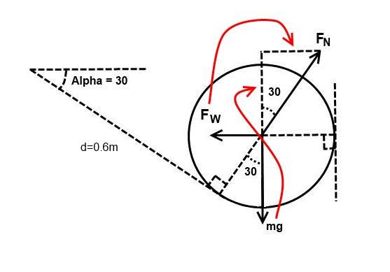

Not sure I follow what stockzahn is saying but I also made this drawing that shows that Fw is effectively already included in FN. …
So Fw = MgTan(30) = FnSin(30)

Thanks so much for your help... but i have a question .
you said that since the object isn't moving vertically then FN*Cos(30) = mg, which mean that the total magnitude of Fn is greater than mg.
so my question is ... Since mg is the only exterior force acting on the object then how could a magnitude of a counter force exceed it?
We aren't calculating Fn produced as a result of mg.
What we are calculating is the force Fn required to hold it still. This calculated value is then compare with the torque provided by the 49N force the other end. Since one is greater than the other it's not still but accelerating.
Imagine if the plank was at a much greater angle, say 89 degrees, nearly vertical. With no friction the beam would have to press the cylinder very hard against the wall to stop the cylinder falling.
If the angle was zero, horizontal, the beam would only have to provide Fn=mg to stop the cylinder falling.
If the cylinder was stationary Fn could still be greater than mg. The cylinder is acting like a wedge between the plank and the wall. The force required to drive a wedge between two surfaces is less than the force pressing them together (ignoring friction).

Ok ... to make it more clear for me let's imagine something else .
The same last diagram you drawn but this time there is no seesaw but it is an object on a ramp that have the same angle we used, this ramp has a vertical wall attached to it in which the object is stuck infront of it.
Also there is no friction.
Will the same calculations we previously used appy?
Yes...
If this is still difficult to understand think about the tension in a tightrope. The tension must far exceed the weight of the man balancing on it. Indeed if you try and make the tightrope perfectly horizontal the tension required is infinite.

Can also draw a free body diagram (with comments) for the ramp and wall combo..
Note that the horizontal force on the wall and the horizontal component of the force on the ramp create a tension in the combined structure.
