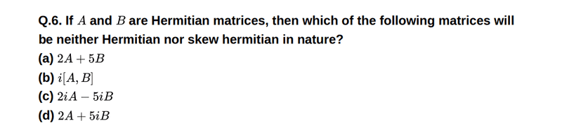

Q.6. If A and B are Hermitian matrices, then which of the following matrices will
be neither Hermitian nor skew hermitian in nature?
For a Hermitian Matrix A,
1. $A^{\dagger} = A$
2. $iA$ is a skew-Hermitian Matrix
I don't know how to simplify option b)
I mean, I don't know how to take the transpose of a matrix which exists as a product of $\iota$, how can I solve this further?
I need help only with option c. I have attempted this previously and have gotten what seems to be the right answer, but I don't know how I did that now

The sum of two Hermitian Matrices is also a Hermitian matrix. But, I still get how to solve c though. I want to take the transpose of i[A,B], how can I do this?

I didn't unfortunately, I did try and do it now which is attached, but I am pretty sure there's an easier way as I am not supposed to do this in the exams.

That's okay. Perhaps it could be simpler, but all the steps are correct.

For example, you could first show that ##[A,B]## is skew-Hermitian, hence ##i[A, B]## is Hermitian.
Thank you! of c! I forgot the fact that [A, B] can also be treated like a matrix (even though it doesn't look like a conventional matrix)
This is what I was looking for
Likes vanhees71
if A is skew-Hermitian then ##(iA)^{\dagger} = iA## making ##iA## skew-Hermitian$$(iA)^\dagger = i^*A^\dagger = -iA^\dagger = -i (-A) = iA$$
edit: I corrected something stupid I said
You meant if ##A## is skew-Hermitean than ##\mathrm{i} A## is Hermitean, and that's in fact what you correctly have proven.
