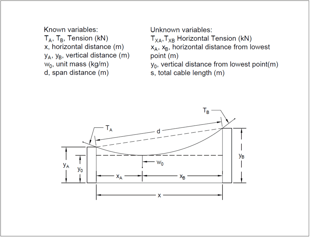

I am developing a model for transmission line cables and I need help calculating the cable sag as a function of a couple of variables. It seems like I have enough information to solve this problem, however I am unable to find a solution to this. Please advise.
Hi all,
I am no structural engineer and I have toiled extensively over this for far too long and at this point I am wondering if this problem has a solution with the given variables...
It is my understanding that the standard equation for a Catenary is: ##y = a \cdot cosh(\frac {x}{a})##. However, I feel this equation does not apply to my problem (attached pdf or figure to the right).
It seems that everywhere I look, there are Catenary problems such as this source which gives the span as well as the sag and then the problem is solved using the given variables. In my problem, I only have the span, total Tension and differential height.
The following equations are what I have tried (variables are form the source):

You see, my problem formulation comes from two transmission towers spaced apart at different elevations, ##P(x_a, y_a)## and ##P(x_b, y_b)##. This is throwing me off, because ultimately I figure it should be the normal equation since I have the span distance, ##d## and then simply add the formula to a line of slope ##mx+y_0##.
There are a couple of cases that I want to look into:
  1. ##T_A = T_B##, and create a solution based on this condition. Where ##y_A = y_B## as well as ## y_A \ne y_B##.
  2. Since the higher tower, ##B##, is going to have higher tension, set the known variable, ##T_B##, and solve for ##T_A## as well as a solution for sag and other parameters.
There is a similar problem in the source mentioned above, Example 10, however this problem gives a sag and solves for the tension afterwards...
The closest I feel I have come in this is the following (with my problem's variables substituted):$$ x_B = y_0 \cdot cosh^-{1}(\frac {y_B} {y_0})$$
$$ x_A = y_0 \cdot cosh^{-1}(\frac {y_A} {y_0})$$
$$ x = x_B - x_A$$
$$ y_0 \cdot cosh^{-1}(\frac {y_B} {y_0}) + y_0 \cdot cosh^{-1}(\frac {y_A} {y_0}) - x = 0$$
This equation does not take into account the Tension, someone please advise on what to do. From what I can understand, I should be able to derive and equation which I could take the limit of the T as it approached infinity, the sag should be zero.

I would start by "completing" the catenary and considering two towers of equal heights that are ##2x_B## apart. Then you know that the appropriate equation is ##y(x)=y_0\cosh\left(\dfrac{x}{y_0}\right)##. You get two equations
##y_A=y_0\cosh\left(\dfrac{x_A}{y_0}\right)##
##y_B=y_0\cosh\left(\dfrac{x_B}{y_0}\right)##
and a third equation relating the span distance to the horizontal separations by the Pythagorean theorem,
##d^2=(y_B-y_A)^2+(x_B+x_A)^2##. Are you sure the "span distance" is not the horizontal separation of the towers in which case ##d=x_B+x_A##? In either case, you have a system of three equations and three unknowns that can be solved numerically. Once you have numerical values for ##y_0##, ##x_A## and ##x_B##, you can find the tension using the "complete" catenary equation.

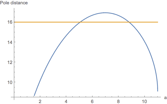

I don't believe there is a single analytic expression that can give you what you want. That's because you need to solve an equation numerically. Constant ##a## is a scaling parameter that scales both ##x## and ##y##. In other words, you can express all lengths in units of ##a## instead of in meters or feet and set ##a=1## in the equations. What specifies the actual unit of length to be used is the separation between poles, ##d##. Therefore to get ##a## in the right units, you have to solve the equation relating the two as shown in post #6 and that requires a numerical solution. The tension as an input parameter does not help. You can write ##T_1=aw\cosh(x_1/a)##⁡, but you don't know the distance ##x_1## unless you first find ##a##! See below how to sort that out. Maybe you need to reformulate the model that you are trying to build.
I gave you all the pieces you need to find the tension once you have the value of ##a##, but it looks like you are uncertain about what you know and what you need to find and how. Let me walk you through a calculation and move forward from the example that I started in post #6.
You are given two vertical poles of heights ##y_1=11.0~\mathrm m## and ##y_2=15.0 ~\mathrm m## spaced distance ##d=16.0 ~\mathrm m## apart. You attach a chain between them of linear mass density ##\mu =1.50 ~\mathrm{kg/m}## and you want to calculate the tension at the poles. Fair enough?
First we solve the equation ##d=\dots## to find ##a## as I discussed in #6. We get two values, ##a_1=5.06~\mathrm m## and ##a2=8.81~\mathrm m##. We will proceed with the smaller value.
Next we find the distances ##x_1## and ##x_2## from the lowest point of the catenary.
$$x_1=a\ln\left(\frac{y_1}{a_1}+\sqrt{ \frac{y_1^2}{a_1^2}−1}\right)=5.06(\mathrm m)\ln\left(\frac{11.0}{5.06}+\sqrt{ \frac{11.0^2}{5.06^2}−1}\right)=7.14~\mathrm m \\x_2=a\ln\left(\frac{y_2}{a_1}+\sqrt{ \frac{y_2^2}{a_1^2}−1}\right)=5.06(\mathrm m)\ln\left(\frac{15.0}{5.06}+\sqrt{ \frac{15.0^2}{5.06^2}−1}\right)=8.85~\mathrm m$$Check: ##x_1+x_2=7.14~\mathrm m+8.85~\mathrm m=15.99 \mathrm m##. That's ##16.0\mathrm m## to three significant figures which is the accuracy of this calculation.
The length of the chain measured from the lowest point to any other point is given by ##s=a\sinh(x/a)##⁡. Let's find that to the tip of the poles.$$s_1=5.06(\mathrm m)\sinh(x_1/a_1)=5.06(\mathrm m)\sinh(7.14/5.06)=9.76~\mathrm m\\s_2=5.06(\mathrm m)\sinh(x_2/a_1)=5.06(\mathrm m)\sinh(8.85/5.06)=14.1~\mathrm m.$$⁡⁡⁡⁡The total length of the chain is ##s=s_1+s_2=9.76~\mathrm m+14.1~\mathrm m=23.9~\mathrm m.##
Now for the tension. Equations 5 and 6 in the source you provided are very relevant. The variable ##c## in these equations is our variable ##a##. Equation 5 says that the horizontal tension is the same no matter where you are along the catenary (that's the catenary hallmark). So,$$T_x=T_0=wa=μga_1=1.50~\mathrm{kg/m}\times 9.80~\mathrm{m/s^2}×5.06~\mathrm{m}=74.4 ~\mathrm{N}.$$Equation 6, ##T=wy##, gives the total tension in the cable. We can use it with ##y=a\cosh(x/a)##⁡ to find the total tension at each pole,$$T_1=\mu ga_1\cosh(x_1/a_1)=1.50~\mathrm{kg/m}\times 9.80~\mathrm{m/s^2}×5.06~\mathrm{m}\cosh(7.14/5.06)=162~\mathrm{N}\\T_2=\mu ga_1\cosh(x_2/a_1)=1.50~\mathrm{kg/m}\times 9.80~\mathrm{m/s^2}×5.06~\mathrm{m}\cosh(8.85/5.06)=220~\mathrm{N}.$$Knowing the total tension and the horizontal component, we can use the Pythagorean theorem to find the vertical component. Perhaps you might wish to use this as a practice template and find all of the above quantities pertinent to the other solution, ##a_2=8.81~\mathrm{m}.##

Albeit, there may be two solutions but I think I can come up with an initial value equation to train the solver to guide it towards the desired solution.
I think I am going to look into the matter of the two solutions some more myself. Perhaps we can compare notes later on.

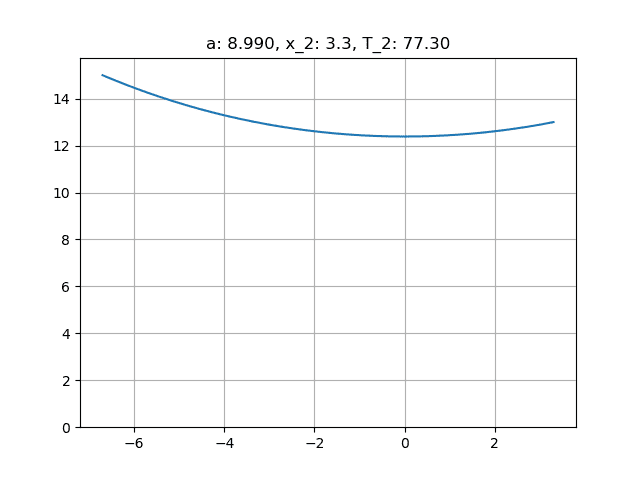

Ok, I've solved it but ohh boy is it a headache... I didn't want to, but I've solved it using multivariate Newton-Raphson method.

Below is the test code I used in Python with some success (see below the code for future work):
Catenary Newton-Raphson Solver:
from numpy import *
from numpy import *
import numpy
import matplotlib.pyplot as plt
def func1(a, x_2):
    return t_1*(sin(arctan(sinh((x_t-x_2)/a))-arctan(y_t/x_t)) + cos(arctan(sinh((x_t-x_2)/a))-arctan(y_t/x_t))*tan(arctan(sinh((x_2)/a))+arctan(y_t/x_t))) - g*m*(a*sinh(x_2/a)+a*sinh((x_t-x_2)/a))
def func2(a, x_2):
    return a*cosh(x_2/a)-a*cosh((x_t-x_2)/a)-y_t
def dfunc1_da(a, x_2):
    return t_1*(((x_t-x_2)*tan(arctan(sinh(x_2/a))+arctan(y_t/x_t))*sin(arctan(sinh((x_t-x_2)/a))-arctan(y_t/x_t))*cosh((x_t-x_2)/a))/((pow(sinh((x_t-x_2)/a),2)+1)*a*a)-((x_t-x_2)*cos(arctan(sinh((x_t-x_2)/a))-arctan(y_t/x_t))*cosh((x_t-x_2)/a))/((pow(sinh((x_t-x_2)/a),2)+1)*a*a)-(x_2*pow(1/cos((arctan(sinh(x_2/a))+arctan(y_t/x_t))),2)*cos(arctan(sinh((x_t-x_2)/a))-arctan(y_t/x_t))*cosh(x_2/a))/((pow(sinh(x_2/a),2)+1)*a*a))-(g*m*((sinh((x_t-x_2)/a)+sinh(x_2/a))*a+(x_2-x_t)*cosh((x_t-x_2)/a)-x_2*cosh(x_2/a)))/a
def dfunc1_dx_2(a, x_2):
    return t_1*((sin(arctan(sinh((x_t-x_2)/a))-arctan(y_t/x_t))*cosh((x_t-x_2)/a)*tan(arctan(sinh(x_2/a))+arctan(y_t/x_t)))/(a*(pow(sinh((x_t-x_2)/a),2)+1))+(cos(arctan(sinh((x_t-x_2)/a))-arctan(y_t/x_t))*cosh(x_2/a)*pow(1/cos((arctan(sinh(x_2/a))+arctan(y_t/x_t))),2)/(a*(pow(sinh(x_2/a),2)+1))-(cos(arctan(sinh((x_t-x_2)/a))-arctan(y_t/x_t))*cosh((x_t-x_2)/a))/(a*(pow(sinh((x_t-x_2)/a),2)+1)))) - g*m*(cosh(x_2/a)-cosh((x_t-x_2)/a))
def dfunc2_da(a, x_2):
    return ((x_t-x_2)*sinh((x_t-x_2)/a))/a-(x_2*sinh(x_2/a))/a-cosh((x_t-x_2)/a)+cosh(x_2/a)
def dfunc2_dx_2(a, x_2):
    return sinh(x_2/a)+sinh((x_t-x_2)/a)##Pole 1 is higher than pole 2, thus pole one's tension is the limiting factor.
##If pole 2 is higher than pole 1, this will still solve with the tension in pole 1 as the limiting factor.
x_t = 10            ##meters
y_1 = 15            ##meters
y_2 = 13            ##meters
y_t = y_2 - y_1     ##meters
t_1 = 120           ##Newtons
g = 9.81            ##m/s^2
m = 1.00            ##kg/m
iter_max = 300
i = 0
tolerance = 1e-3
error = 1
x_2_min = 1e-6
a_min = 1e-12
x = matrix([[x_t],[x_t/2+x_2_min]])
while i < iter_max and error > tolerance:
    disp(x.T)
    J = zeros([2,2])
    f = zeros([2,1])
    J[0,0] = dfunc1_da(x[0,0], x[1,0])
    J[1,0] = dfunc2_da(x[0,0], x[1,0])
    J[0,1] = dfunc1_dx_2(x[0,0], x[1,0])
    J[1,1] = dfunc2_dx_2(x[0,0], x[1,0])
    f[0,0] = func1(x[0,0], x[1,0])
    f[1,0] = func2(x[0,0], x[1,0])
    x = x - matmul(linalg.inv(J),f)
    i = i + 1
    error = abs(numpy.max(f))
    disp("error: %.3f" % (error))
disp(x)
disp("total iterations: %i" % (i))
a = x[0,0]
x_2 = x[1,0]
x_1 = x_t - x_2
x = numpy.linspace(-x_1, x_2, 200)
y = []
y_0 = y_1 - a*cosh(-x_1/a)
for val in x:
    y.append(a*cosh((val)/a) + y_0)
plt.plot(x, y)
theta_1 = arctan(sinh((x_t - x_2)/a))-arctan(y_t/x_t)
theta_2 = arctan(sinh((x_2)/a))+arctan(y_t/x_t)
t_2 = t_1*cos(theta_1)/cos(theta_2)
plt.title("a: %.3f, x_2: %.1f, T_2: %.2f" % (a, x_2, t_2))
plt.grid(True)
plt.ylim([0, numpy.max(y)*1.05])
plt.show()
plt.close()
In this code, there are a couple of things to consider and I need your help to figure-out the following...
  • The tension must be a minimum or it will not converge. What is this value and how can one calculate the minimum tension for this to converge?
  • In the code, you will see that the variable matrix x, contains the catenary constant, ##a## in the first row (position x[0,0]) and ##x_2## in the second row (position x[1,0]).
    • The solver will not converge if the initial value of ##a## is small, however I cannot determine why. For this issue I am sure there is a way to determine the best initial guess.
    • The ##x_2##, when the tension is high enough, can be greater than ##\Delta x## which surprised me, but makes sense. I just didn't see that coming.
  • I am curious as to how we could formulate this code as such so I don't have to rewrite for the case where pole 2 is greater than pole 1. I know I could just switch the poles and the solution is the same, but my brain is fried.
I wrote this up quickly but have spent a long time on this outside of this forum. I would love your help moving forward if you could.
Thanks,
Tanner H.

Finally, you show a graph of a catenary. What numerical input parameters did you use to generate it? Pehraps I can use my methods to see if I can reproduce it.
Wait, hold on...
It works only if trained initial guesses. That is the main problem. It looks like there are tons of solutions to each given. I am traveling tomorrow and I am putting this down for now. Please don't look further into this until I can sort out why the behavior of the convergence is so dependent upon the initial guess.
To answer your question about the constant, ##a##, I was mislead by the fact it is a constant. Usually constants are unitless, thanks for catching that.
To answer the graph comment, I updated the code after the fact and forgot to update the graph that included the solver's final conditions.

Comments and observations on post #11
1. In equation (7) you write ##y(x) = a \cosh {\frac {x} {a}} + y_0##. What is ##y_0## and why is it necessary to have it? When ##x=0## the equation predicts that ##y(0)=a+y_0##. I assume that this is a typo.
2. Equations 13-17 are correct. However, the trig functions involving angle ##\theta## can be simplified. The slope of the curve at some value of ##x## is $$\tan\theta=\frac{dy}{dx}=\frac{d}{dx}\left[a \cosh\left(\frac{x}{a}\right)\right]=\sinh\left(\frac{x}{a}\right)=\frac{s}{a}.$$This suggests a right triangle as shown below. Note that the hypotenuse is ##y## and that the Pythagorean theorem is satisfied in accordance with equation 2 in post #1 (with ##c=a##).
From the triangle we deduce that ##\sin\theta=\dfrac{s}{y};~~\cos\theta=\dfrac{a}{y}.##
3. You have missed an important equation which is obtained by demanding that a segment of the catenary from the lowest point (##y=a##) to an arbitrary point ##y## must be in equilibrium. From the free body diagram shown below
Horizontal equilibrium: ##T \cos\theta=T_0##
Vertical equilibrium: ##T\sin\theta=w_0s##
Divide the bottom equation by the top to get ##\tan\theta=\dfrac{w_0s}{T_0}=\dfrac{s}{a}~\rightarrow~T_0=w_0a##.
The total tension is $$T=\frac{T_0}{\cos\theta}=\frac{w_0a}{\frac{a}{y}}=w_0y=w_0a\cosh(x/a)$$The components of the tension are$$T_x=T\cos\theta=w_0y\times \frac{a}{y}=w_0a=\text{constant}\\T_y=T\sin\theta=w_0y\times\frac{s}{y}=w_0s=w_0 a\sinh(x/a)$$Note that the right triangle formed by ##T##, ##T_x## and ##T_y## is similar to the right triangle shown above. Their sides are proportional to each other with the constant of proportionality being ##w_0##,$$T=w_0y;~T_x=w_0 a;~ T_y=w_0 s.$$4. The most important realization you should come to is that angle ##\theta## is irrelevant so stop trying to find expressions for it. What you care about are the trig functions of ##\theta## and these you have either in terms of ratios of sides in the length triangle or in the tension triangle. That will simplify your code and preserve your sanity. My advice is to toss out everything past equation (17) and start over again.
5. Is your goal to find a single equation relating given parameters ##T_A##, ##T_B##, ##y_A##, ##y_B##, ##x_A+x_B##, ##w_0## with unknown parameter ##a## and solve that equation to find ##a##? If so, please note that the tensions ##T_A## and ##T_B## are redundant as given parameters because ##T_A=w_0y_A## and ##T_B=w_0y_B##. So really this goal is to find a single equation relating given parameters ##y_A##, ##y_B##, ##x_A+x_B##, ##w_0## to unknown parameter ##a##. But this goal was reached in post #6. Furthermore, in post #8 I showed you how to solve for ##a## and determine the rest of the unknown quantities. If you agree that this is your goal, then your task is to write code to solve the equation in post #6 and calculate the rest of the unknown quantities.
If this is not your goal, then please specify what your goal is so that I can see if there is something I can do to help you reach it. I hope I have convinced that the tensions are useless as input parameters if you know the pole heights and the linear weight density.
