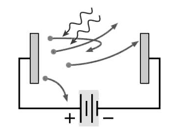

Photons with momentum p= 7.88 x 10-18 strike a photoelectric material which is in the configuration shown in the figure. The cutoff voltage is measured to be Vstop= 1.75 V. What is the work function of the photoelectric material?
p = Ephoton / c
E0 = (c ⋅ p) - (Vstop ⋅ e)
E0 = (3.00 x 108 m/s)(7.88 x 10-18 (ev ⋅ s)/nm) - (1.75 V ⋅ 1.602 x 10-19 J) = 2.36 eV

you should convert the speed of light to nm/s to match the momentum unit (ev.s/nm)
Likes ikihi
Thanks for catching that error. The new answer I got is 2.36 eV
you are welcome.
thats still the energy of the photon
subtract that from the ke
