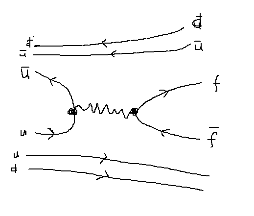

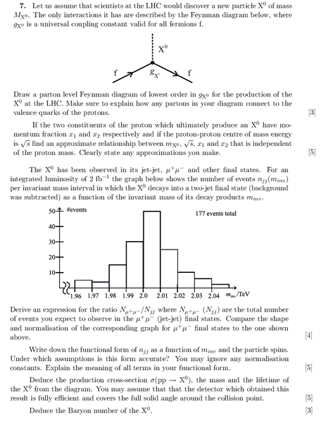

(a) Draw the feynman diagram for ##p \bar p \rightarrow## reaction.
(b) Find an expression for mass of the particle.
(c) Find an expression for number of ##\mu^{+} \mu^{-}## produced.
(d) Find an expression of ##n_{jj}## in terms of ##m_{inv}## and its spin.
(e) Deduce the crosssection and lifetime.
(f) What is its baryon number?[/B]
Part(a)

I have no idea how to start part (c). I know this particle couples equally to all fermions?

So for part (c) it is essentially ##\frac{\Gamma_{\mu^{+}\mu^{-}}}{\Gamma_{jj}} = \frac{1}{(3 \times 3) + 3 + 3} = \frac{1}{15}##? There are ##3 \times 3## states for hadrons, ##3## states for lepton-antilepton and ##3## for neutrino-antineutrino. Is the particle the higgs boson?

Is my ratio ##\frac{1}{15}## right?

Are all 6 quarks possible? If so then the ratio becomes ##\frac{1}{3 \times 6 + 3 +3} = \frac{1}{24}##.

I don't understand the part where they want us to "compare the shape of normalization for ##\mu^+\mu^-## to the graph above". I found the ratio to be ##\frac{1}{24}## which implies about ##7## out of ## 170 ## events.

Ok, then for part (d): How is the number of events related to its spin? I thought the number of events is simply related to the cross section ##\sigma##?
Hmm... looks like Breit-Wigner can depend on spin somehow, but I don't know details.
